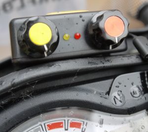

PowerletHeat Controllers
Warmth on tap is great, but sometimes heated gear can get a little too hot. Being able to control the temperature of a jacket is ideal. Most heated jackets these days have various heat settings to make them suitable for a variety of cold weather situations.

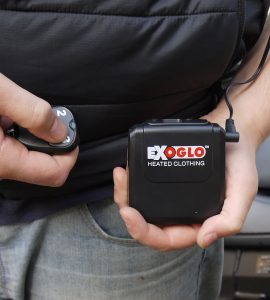

EXO2 ExoGlo3 Body Warmer
£129.99 | www.exo2.co.uk
Kicking off our reviews at a very reasonable £129.99 is the ExoGlo3 Body Warmer, a sleeveless heated liner which features PrimaLo Gold synthetic insulation as well as three heated zones to help keep you warm while riding this winter. The gilet comes with the facility to wire it up to your bike’s battery as standard but for an extra £43, you can purchase a very useful and neat portable battery pack with a wireless remote and three heat settings.
ControllerPack
The handy portable battery pack with wireless controller
In the years of testing outdoor gear, PrimaLo consistently impresses and once again it does a great job in the ExoGlo3, trapping warm air very effectively and working well to keep you cosy. The heated elements on the gilet run around the chest and the upper back. This means that you’ll find the heat protecting your vital organs, but we believe that a heated jacket should be about comfort, not just survival, and we would have preferred a larger area covered by the heat.
A look at the heat map below shows that the majority of the warmth is placed on the upper of the back with very little actually coming around the front.
It’s disappointing to note that there’s no temperature adjustment facility as standard (an in-line controller can be bought for an extra £49.96), though we really like the optional extra battery pack and wireless remote and three heat settings. This is perfect for those cold days when you’re walking around off the bike. The fit of the gilet perhaps comes out on the large side (I usually wear an XL and an L fitted me pretty perfectly) so bear this in mind when buying.
In all, it’s a nice gilet considering it’s the cheapest in this test, but it’s very basic unless you spend the extra money for the battery pack and remote or in-line control.

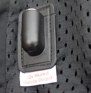

Accessory plugin points
The heat is in this body warmer is provided by heat panels positioned on the upper back, kidneys, collar and chest and they have a typical power of 40W with a current drain of 3.3A, offering a nice amount of warmth without major power drain affecting the bike’s battery. The heating elements protect the body’s vital organs nicely and the heat seems to resonate throughout the rest of the garment, as you can see in the heat map below and left.
The Hi Powered Bodywarmer comes with everything you need to get it wired up to the bike and if you’ll be using any other heated products then it’s nice to know that various outlet points on the gilet will allow you to connect them up with minimal fuss and wire tangling. For times when you’re not on the bike all wires can be zipped away to keep them tidy and easy to find.

Wireless temperature controller
The CNC heating is provided via thin and flexible panels on the chest, upper back, arms and neck and a look at our heat map will show you that it keeps all the important parts of your body nice and warm. The heat provided by the infra-red technology isn’t particularly smoother or deeper than the heat in, say the Gerbing jacket, but it does warm up incredibly fast.
The RapidFire Jacket comes with dual-power connectivity so that you can choose to run it at either 105 or 60-watts, a lifesaver for those with smaller bikes as the 60-watt option will allow full use of the liner without putting too much strain on the bike’s battery. Excess wiring can be tidied up in individual zipped pockets and there’s a nicely sized, very handy zipped chest pocket for storing wallets, phones etc. and it also doubles up as a stuff sack for the jacket when not in use.
For an extra £77, you can get an incredibly useful wireless control unit which allows easy adjustment of the temperature settings as if you were turning on an oven (the red knob is for the jacket and yellow is for the optional heated gloves).
