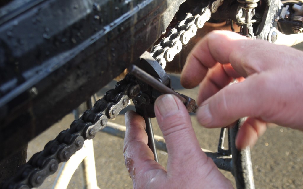

Before you head off, check the condition of your chain and sprockets on the bike. ‘Hooked’ sprockets will mean replacement is needed. To check the chain it’s as simple as gripping it on the rear sprocket and pulling away from it. If it lifts off, leaving a gap between the chain and the sprocket, then it’s worn and time to replace.
![](https://www.adventurebikerider.com/wp-content/uploads/2021/04/P1040095.jpg)
A chain and sprocket kit is really quite cheap if bought wisely, try and find a kit with a good brand of chain, D.I.D or Isumi are usually top-notch. When ordering, if your bike spec is for 115 links order 120 links. Bung the extra links in a plastic bag and keep them in the tool kit that you keep on your bike, you’ll thank me later.
You’ll also need a chain link splitter. These can be bought from as little as a tenner, get the best that your budget will stretch to.

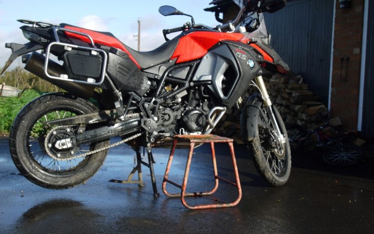

By this time you can see where I’m heading. That’s right, fit a new chain before you leave. It’s a really easy job that can be done by the home mechanic. A workshop or Haynes manual is a help but you can usually find all the information you need on various forums on the internet – the ABR forum (www.adventurebikerider.com/forum) for one is full of knowledgeable folk with great advice. If you’re lucky enough you may even find a member who lives nearby that can help you in exchange for a mug of tea and a few biccies.
Once you’ve accomplished this task a breakdown on the roadside will seem far less daunting.

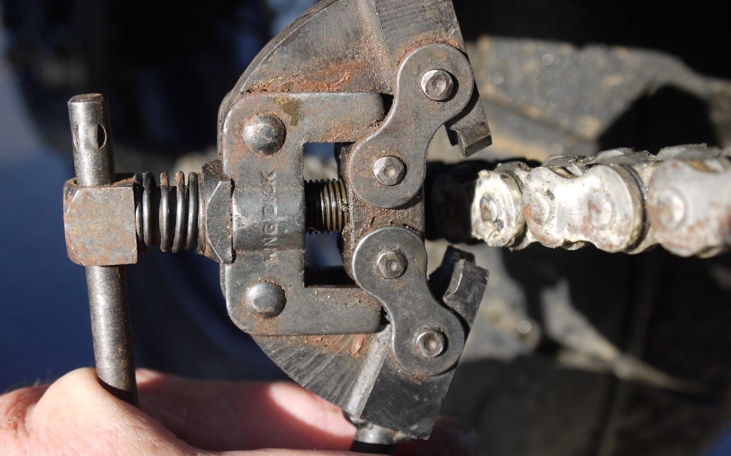

So what happens if the chain breaks on a mountainside? Dig out that plastic bag (remember, the one with the extra links in?) and your chain splitter, remove the offending damaged links and substitute the spare links and split links, making sure the closed end is pointing in the direction of travel.
