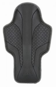

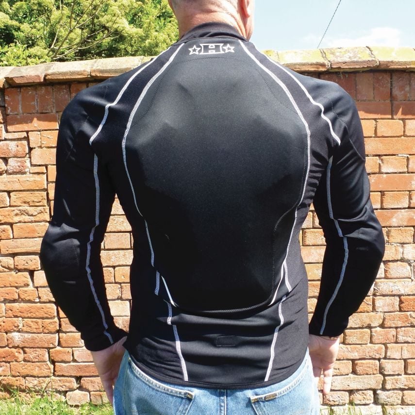

Halvarssons Torso Vest
£99 (secure L2 backplate £54) www.jofama.se
If you’re looking for a body armour vest that ticks all the boxes and can be used on and off the tarmac then the Torso will see you right. However, you’ll need to purchase the Secure L2 back plate at an additional £54 to complete the jacket. Still, £150 for complete upper body protection that’s suitable for use just about anywhere isn’t bad.
is an additional £54
The vest itself is made from a mixture of spandex and mesh that not only ensures a snug fit and holds the protective plates in the right position it also allows cool air to circulate and wick away sweat. The added beauty of this type of garment is that all the pads can be removed so it can be laundered, to freshen it up.
There are also thumb loops, which keep the sleeve cuffs from riding up. A front zip runs the length of the jacket. This is spring-loaded and can be locked into place at any point on the runner, which is useful if you want to open the front of the jacket to get more ventilation, but don’t want it completely undone.
The armour in the shoulders, elbows, and back has full CE certification to the latest standard. It’s also comfortable and conforms to the shape of your body’s contours within a short period of time, so you hardly notice you’re wearing it.
It has chest pads, which although not CE marked will withstand being struck by flying objects without the impact being felt to any great degree. I’ve found this vest to be very comfortable when riding and the armour stayed in place under my outer jacket.
The vest was warm enough to wear in cool temperatures without having to add any extra layers, and when temperatures rose, I didn’t feel as though I’d overheat. The vest doesn’t have a high collar, so your textile outer jacket won’t feel bulky in this area.
ABR Rating: 9/10
In a line: Comfortable jacket and armour well worth considering
With backplate | Thumb loop | Unobtrusive armour |

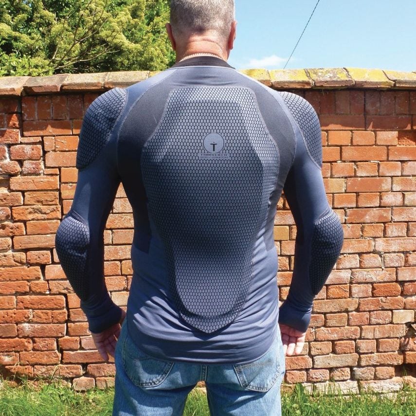

Forcefield Pro Shirt
£189.99 www.forcefieldbodyarmour.com
Forcefield is one of the biggest manufacturers of protective armour. Its products are used in a multitude of motorcycle garments and are the protection of choice for many professional road racers. It’s good stuff. Nuff said.

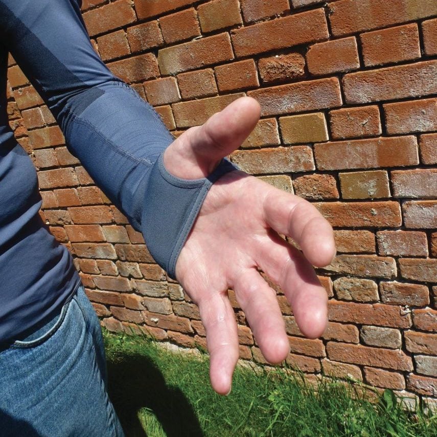

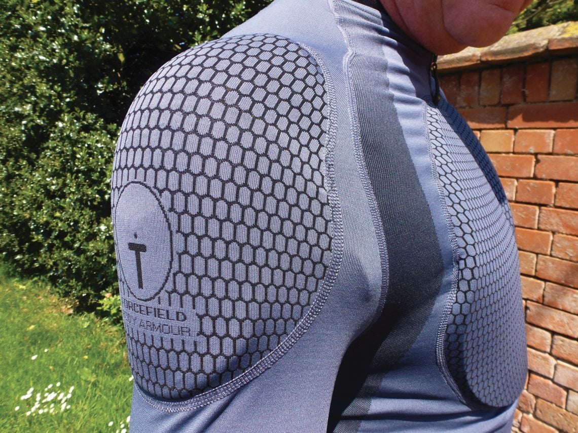

I’d seen the Pro Shirt in use by quite a few motorcyclists, both on-and off-road before I got my grubby paws on one, and now I’ve had the chance to try it out, I can fully understand why so many riders choose to put their faith in such a product.
The shirt is made from BeCool fibre, a close-fitting fabric that ensures the armour stays where it should be; it’s also breathable, to allow body heat and moisture to escape and fresh air to circulate. The sleeves feature thumb loops, which stop the cuffs from riding up and essentially keep the elbow pads secure.
As Forcefield manufactures the armour it stands to reason that all the pads used in the Pro Shirt conform to the latest CE standards, which includes the shoulder, elbow, back and even the chest pads.
Not that anyone would intentionally want to test the armour, but it also features RPT (Repeat Performance Technology), which means the pads offer the same level of protection after multiple impacts unlike, say, a helmet, which is compromised after an impact and would need replacing.
The pads are also easily removed, to enable the garment to be machine washed. The fit of the Pro Shirt is spot-on; the armour sits exactly where it should and very quickly moulds to the wearer’s body shape.
Worn under a conventional outer jacket (armour removed) it’s hardly noticeable and the low collar doesn’t hamper the fit of your top layer either. The BeCool fabric works well to keep you dry and comfortable when it’s warm but on cooler rides, it acts as an extra layer. I didn’t feel as though I needed anything else to keep out the chill.
ABR Rating: 10/10
In a line: All-round protection with all-day comfort. Recommended.
Back protection | Thumb loops | Shoulder pads and chest plate |

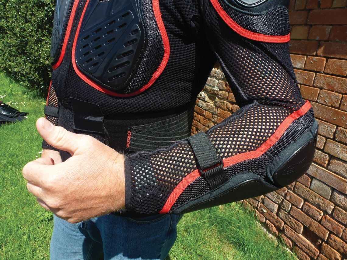

Alpinestars Bionic 2 Protection Jacket
£199.99 www.alpinestars.com
What looks like and is labelled as a protective jacket for off-road pursuits comes with a hefty price tag. But I’ve always expected to pay a premium when it comes from a manufacturer like Alpinestars because it has a heritage of using top-quality components tested to the highest level and the Bionic 2 protection jacket is no exception to this. If you want the best you have to pay for it.
The jacket features DFD (dynamic force dispersion) technology, which means that although the protector is lightweight and isn’t too bulky it conforms to the latest CE standards that afford the wearer the best protection when riding away from the tarmac.
Constructed from stretch mesh fabric with a stretch Cordura panel on the back, the jacket has a snug comfortable fit which offers plenty of ventilation to keep you cool.
The main body of the jacket is short, but the detachable backplate extends beyond this and its dual kidney/body belt then wraps around the front of the jacket and is attached with two small Velcro tabs.
There are adjustment tabs on the forearms and the shoulders, to fine tune the fit, but more importantly, they also hold the armour in place. As mentioned the back armour is detachable from the jacket and can be worn as a stand-alone garment.
It features a five-plate construction, which is contoured for a natural fit. The plates lock to prevent overextension of the back, which is crucial in certain accident situations.
The shoulder, elbow, and back pads are CE approved to level two, but the chest/ roost plates are not; this is because they are ventilated so cannot offer the same level of protection as the rest of the pads. That said, they will offer protection from flying debris.
I’ve worn the Bionic 2 both on-road and off it and I have to say I found the fit was spot on and was comfortable for all-day use on the trails. This would be a suitable alternative to wear on that off-piste adventure to Morocco.
ABR Rating: 8/10
In a line: Top quality for top dollar
Back protection | Forearm adjustment and armour | Shoulder and chest armour with adjustment |
