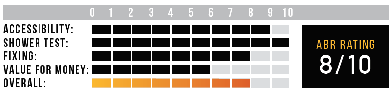

Scoring
Accessibility: You’ve packed your kit but how accessible is it? Can you get to something quickly, or do you have to empty the contents completely. A higher score means your gear is more accessible.
Shower test: All the dry bags are 100% waterproof and do not need an additional waterproof cover, but the tank bags and tail packs are not waterproof by default, therefore how waterproof are they if subjected to a minute of intense soaking without their additional waterproof covers? The higher the score the better they withstand the elements. A minute was given under a power shower to simulate a downpour.
Fixing: How easy is it to attach the item to the bike?
Night away: Can I easily fit in the following for a night away? Jeans, t-shirt, fleece top, socks, boxers, small towel, toiletries, small sleeping bag (luxury), trainers.
Value for money: Is it worth the dosh?

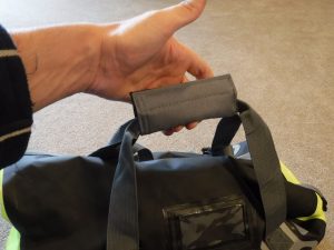

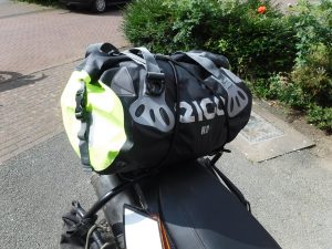

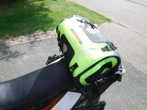

Along with the Spada 40L dry bag and the Kappa Dry Bag, the Richa H20 Cylinder Bag is the cheapest product in this test. Essentially it’s a simple, 30-litre roll bag that’s fully waterproof and made to withstand the harsh environment of the rear of a bike. It’s available in two colours, these being a white and black with reflective details, and hi-vis yellow and black.
As standard, the Richa comes with two straps that can be used to convert it into a rucksack, and that’s the extent of the extras.
These are a nice inclusion, though they offer no padding, so bear that in mind if you’re planning on carrying it for long periods of time. If you want to strap the bag to your bike you’re going to have to use your own straps or bungee cords, using the four fixing points on the bag to anchor it to the bike.
For ease of carrying, as well as the shoulder straps, you get a nicely placed grab handle near the top. A nice touch is the inclusion of cordage on the outer which is great for leashing waterproofs to so that they’re easy to access.
The hi-vis yellow is the one to go for if you want to increase your road presence to drivers behind you. The white and black model features two small reflective patches, which are of minimal use, especially when you consider that only one is going to be visible to those behind you as the other will be facing the rider.

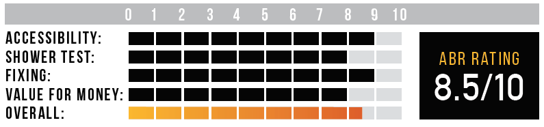

All in all, the Richa H20 Cylinder Bag is a good product. It’s dead simple and no thrills, but sometimes that’s exactly what you want in a roll bag.
At £39.99 it represents good value for money, and with it being the size it is, it also doubles up as a dry bag that you can stash inside your panniers.
Night away: If you pack light, you’ll be fine.
In a Line: Dead simple, but effective.
Fixing: No bungees supplied.
RICHAH2ORating

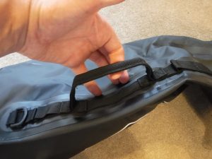

The bag comes with a single carry handle and an additional shoulder strap, but it’s a shame the strap isn’t padded as when fully packed it dug into my shoulders. The WP407 really could do with some additional padding to ease the load.

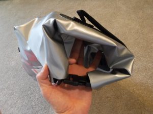

The Bagster Matrix is a 15-litre tank bag that’s more suited to larger bikes as it’s fairly in-your-face when on the tank. At 15 litres it’s on the borderline of being suitable for fitting everything in on a night or two away. On top of the bag there’s a pocket with a really tough to operate waterproof zip. You won’t get much in this pocket but its ideal for a wallet or valuables.
On both sides there are smaller pockets with waterproof zips. The main compartment opens fully to give access to the space inside, again secured by another waterproof zip. There’s a useful strap on the inside for securing gear, which will save it from moving around if the bag’s not fully loaded, and an internal mesh pouch for smaller items.
A great feature is the two built-in rucksack straps which will make carrying the bag when off the bike really easy. Due to the shape, it actually looks pretty good when worn as a rucksack. A front carry handle completes the carrying options.
The bag expands by unzipping the bottom to create additional space if required, which is a great feature, and it’s something that I personally consider essential on a tank bag. There’s an elasticated waterproof bag included with a map viewing window.
So, although the Bagster has water-resistant zips, for fail-safe waterproofing you’ll have to make use of the cover.

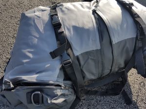

This is one of two Richa tank bags on test and it’s another large offering. Once again, it looks great and has some cracking features. The best of these is the SatNav pouch on the top. This is located under the map holder and is accessed by unzipping the top which reveals the case underneath.
This can be positioned so you can see the SatNav whilst riding while protecting it from the elements. A really good feature.
The tank bag comes with a rain cover included for full weather protection, so just remember that without it your kit isn’t guaranteed to stay dry.
The Richa has a waterproof map holder that secures to the top of the bag well. It has Velcro at the front so you can peel it forward to access the bag. There are straps at the rear so it won’t fly away in the wind or whilst riding (if the Velcro comes loose).
In testing, I found that the main compartment can be a bit awkward to unzip at times. I had to force it open on occasions, and it’s an unfortunate reality that anything that needs forcing open has a higher risk of breaking.
The bag is different from the other Richa on review as this one simply unzips and expands to give more capacity rather than allowing you to zip off different compartments to alter the size.
I much prefer this over the three-in-one approach the Richa Multi tank bag takes, as it allows you to alter the capacity of the bag on the fly without you having to carry the other compartments.

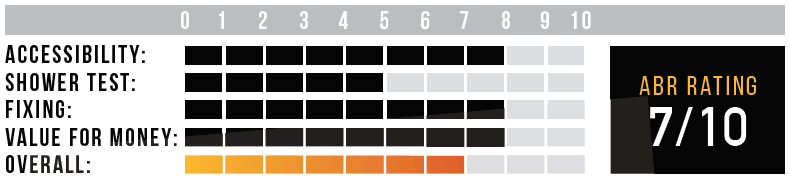

Night Away: Plenty of room for you’re an evening’s worth of gear.
In a line: Large tank bag that will require a large bike to suit.
Fixing: Magnets in the base for metal tanks. No fixing supplied for plastic tanks. I used bungees.
RICHATBRating
