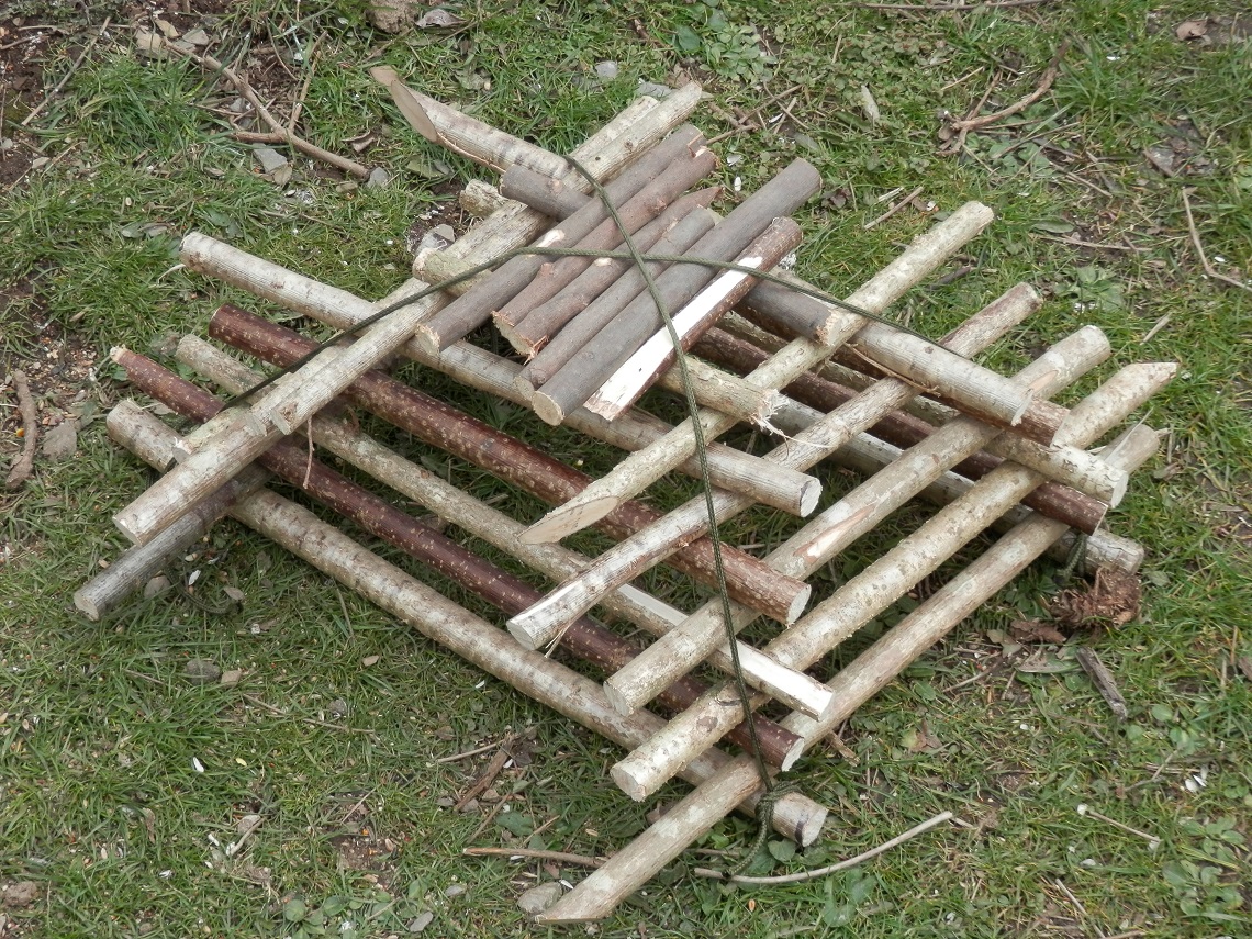

You start with a pair of sticks, securely tie them with a cord to form a rectangle with string as two sides and the sticks as the other two sides. Flip one of the sticks end-for-end so that they are still parallel but the string forms a cross in the middle.
Take two more sticks and push them under the string to form a rectangle. Continue fitting sticks of gradually decreasing length, alternating their direction, until you have your rectangular pyramid with the cross of string tight in the centre of the top. Finish off by pushing more twigs under the cross to make a flat roof.

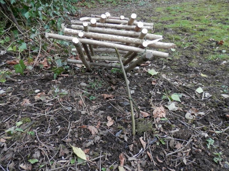

The trap should be tight and firm enough to allow it to be picked up easily without falling apart. The trigger could be as simple as a forked stick on a string that you pull when a bird is under the trap.
Have the trigger on one side of the base and the string running under the trap to where you lie hidden to ensure the stick falls into the trap and does not hold the side open.
![Sticks-build-to-make-a-pyramid](https://www.adventurebikerider.com/wp-content/uploads/2021/04/Sticks-build-to-make-a-pyramid.jpg)
Place your bait towards the back and when a bird enters, pull the string to dislodge the trigger, trapping it. To remove it, push one of the bars inwards (this is why the sticks are not individually tied) and reach under the trap to grab the bird.
