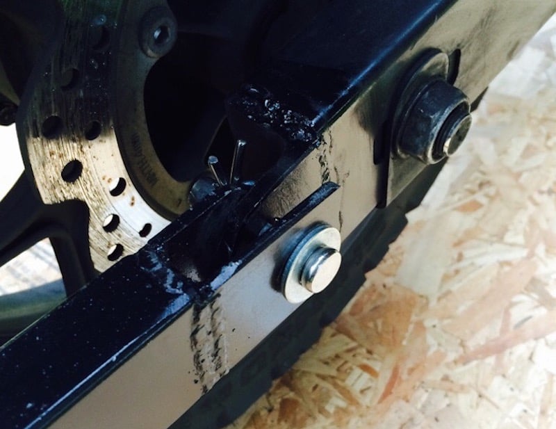

Motorcycle Trailer Hitch
Everything came together nicely and it was on to building the hitch/swing arm for the bike. I built two tabs that mounted to the end of the bike’s swing arm that were held in place by the axle adjustment bolt and welded to the swing arm. Next was the swing arm hitch that needed to clear the rear wheel but not stick out to far so I could keep the rig as short as possible. When it was all done it was time to hook it all together and see if my plan worked.
