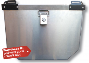

G&G
Model: Alu Premium
Price: £139
Top BoxesFirst off, the G&G is big enough to take a full-face helmet with ease, plus everything else on our essentials list. It’s also heavy at 5.5kg and bulky enough to offset the look of a bike, but you’d not worry about that if you want maximum secured packing space at a budget price.
The designer (Klaus) at G&G knows his stuff alright which is evident in the cut-aways at the bottom, allowing side pannier lids (Metal Mules) to be opened without taking off the top box – something the guys down at Givi need to do a bit more work on when designing a 45l top box aimed at the adventure market.
At £139 this is the cheapest box on test and in the looks and style department it has that bargain basement bread-tin chic. It attaches to the bike via a Touratech-style puck mechanism which doesn’t come close in the convenience and ease of attach/detach league when measured against a Hepco & Becker or Metal Mule but it’s very secure and does the job, at the price. This is not a top box for those who are drill shy.
Top-Box-01
The lid is fully detachable and secured by a single integral lock and clasp on the front which, it has to be said, is not the strongest. The back of the lid hinges on a single metal hoop/clasp and you can forget about opening the box for a quick mooch without the lid coming away in your hand – it’s all a bit Heath Robinson but it works. The lid also comes with enough attachment points to strap on a North Sea Ferry, should you wish.
The box is held together by rivets and a silicon seam sealer and the finish, while acceptable, is a little on the rough side. Waterproofing is by way of a full rubber rand which sits well protected under the lid and performed spot-on in our power-washer test.
Buy these if: You want good space/£ ratio
In a line: Budget buy for those who need the all extra space they can get
ABR Rating 6/10

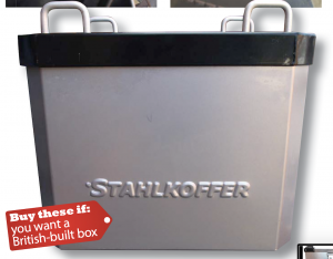

STAHLKOFFER
Model: Aluminium Top Box
Price: £175
Top BoxesThe name might suggest that these boxes are made by a bespectacled ex panzer mechanic deep in the Bavarian Alps but they are, in fact, a product out of the old epicentre of UK manufacturing, the Black Country.
In ABR issue 3 we gained huge respect for Stahlkoffer panniers, a great product at a highly competitive price. If we had a gripe then it’s the slightly agricultural system the company uses for mounting its products to the bike.
If Stahlkoffer could slick up the process and maintain its price advantage then it’d be a serious force in the aluminium luggage market.
The same applies to the company’s top boxes. The product itself is good value and very well made but comes up short on the ease of mounting and dismounting. It’s stable and secure but it’s just not as good as others on test.
The Stahlkoffer is big enough for a helmet and essentials and has the look of a hard-as-nails welded ammo box. The lid is fully detachable which some will like and others will not, and it’s firmly secured with two built-in lock and clasp gizmos. You also get four attachment loops on top for strapping extra gear.
Top-Box-02
The box also comes with a detachable false bottom which is deep enough to store cash, spare keys, passports and other essentials out of sight of the casual thief or neatly away from the other clutter in the box. It’s a nice touch but not an essential feature and in our view only adds to the price and weight of the product.
When all is said and done, the fact is that Stahlkoffer has produced a quality top box at a price that makes other top brands appear very expensive. That said, you’ll have to compromise on the ease of use and want a detachable lid, as opposed to a hinged lid, which we prefer.
Buy these if: You want a British-built box
In a line: A quality box at a competitive price
ABR Rating 7/10

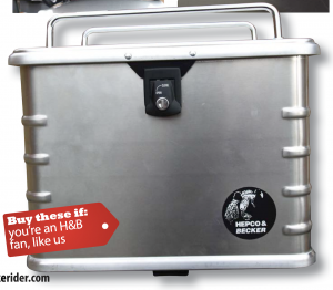

HEPCO & BECKER
Model: Alu Standard
Price: £213
Top BoxesWe like Hepco & Becker luggage down in the ABR office. The company’s panniers, which complement this top box, were highly rated in issue 3 and have proved faultless in use. The quick release system, easy-on-the-eye design and value for money when compared to the other big brands should be enough to place the H&B on the shortlist of most adventure bikers.
That said, it’s getting difficult to justify the £29 price difference between the H&B and the Krauser which are essentially the same box – they differ in a few minor fitments and how they attach to the bike.
First off, the 35l Hepco & Becker passes the helmet and essentials size test, which means they all fit in and it’s possible to access the panniers without having to remove the top box. Fixing the mounting rack to the Tiger was a two-minute job and the box attaches in seconds by way of a single-locking (same key opens the lid) clasp. We’ve nothing to doubt that the system is anything other than secure but we were able to move the box sideways with very little effort, though it has to be said it was never in danger of detaching. As with the Krauser the under box locking mechanism is exposed to damage when the box is off the bike and extra care is needed when handling them.
Top-Box-04
This box has the same clean lines and professional finish as the Krauser, so once again it’ll look the part on any motorcycle. The major differences are that there are no side carrying handles on the H&B but there are two huge attachment hoops on the lid which are big enough to double up as carry handles should you need. Other than that it’s only the company logos which differentiate the boxes.
In summary, this is a fine product but is it worth the extra £29 over the Krauser?
Buy these if: You’re an H&B fan, like us
In a line: Would look good on any adventure bike
ABR Rating 7/10

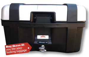

GIVI
Model: Trekker
Price: £240
Top BoxesOkay, this is not an aluminium top box, but it is Givi’s attempt at adventure-styled luggage and there is a token smattering of alloy, even if it’s purely for cosmetic purposes.
The first thing to note about this box is its size, followed closely by, ‘Will it fit on the bike and still allow unencumbered access to the panniers?’ In my case it does not (Triumph Tiger 955i fitted with Metal Mule panniers). I need to dismount the Trekker to open my panniers. Fortunately the Givi quick mount/ dismount system makes this reasonably painless but is it something I’d be happy to do on a regular basis? Probably not.
The second feature to note is that if you turn the Trekker on its side it becomes a pannier and comes in two sizes (46l and 33l) to accommodate bikes with single side exhausts.
Thirdly, this box comes with a nifty feature that allows for part opening – not so much use when it’s a top box but handy for accessing essentials when in pannier mode.
The 46l is cavernous and takes a lid and all the travel essentials with bags of room to spare. The quality of components and construction is as you’d expect from Givi and we’ve no problems in that department plus the monokey system means the box can be opened and detached from the bike with a single turn of the key.
Top-Box-05
Internally there are a couple of straps to keep your luggage secure, which again is more useful when in pannier mode.
So who’s the Givi going to appeal to? Most adventure bike riders buy aluminium luggage for the robust features and, it has to be said, the image and look. The Givi casts a nod to styling by including a part aluminium finish but this is essentially a quality, versatile plastic top box-cum-pannier and there’s really nothing to fault if that’s what you want. But will you be able to open your panniers?
Buy these if: You like sexy-looking luggage
In a line: Quality plastic box that thinks it’s aluminium
ABR Rating 7/10

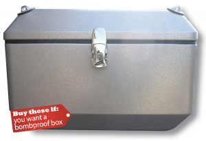

JESSE
Model: Safari
Price: £385
Top BoxesBuying a Jesse top box is not for those who get a rash when they spy a drill or spanner. If you want a Safari and you’re not a keen DIY’er speak nicely to Cliff at Two Wheeled Trekkers (the Jesse importers) and ask him to sort the fitting or you’ll be pulling your hair out. Conversely, those who enjoy their elbow grease will be delighted when they open the box and find three plastic packets full of nuts, bolts, washers and screws.
Once again, the complexity of set up makes it clear that the Jesse heritage lies firmly in the hands of the serious overlander. The top box package consists of three mounting plates, a security box which sits below the top box, a lock that needs to be screwed on and then there’s the top box which needs to be drilled and fitted to a plate. Phew.
The unique feature here is a ‘security box’ on which the main top box sits. It’s lockable and designed as a secure place to store gear you don’t need to access often, like tool kits. It has its advantages, for sure, but is it really necessary?
The top box itself comes with the Jesse ‘eggshell’ finish – which some will like and others not – and is big enough to take a helmet and our travel essentials. The lid is hinged, which we like, has attachment loops on the top and all parts are welded with not a rivet in sight.
Top-Box-07
The main box body is of an all-weld construction, tapered at the base to reduce sharp angle impact areas and comes with a single integral lock to secure the lid. A substantial but exposed rand provides a water tight seal.
If there was a medal for a product that displays a passion for overland motorcycling the Jesse would win. But is it a practical day-to-dayer?
Buy these if: You want a bombproof box
In a line: For the practical hardcore user
ABR Rating 7/10

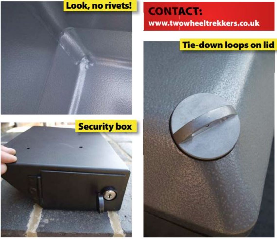

METAL MULE
Model: Max Top Box
Price: £459
Top BoxesIf we suspend the reality that price actually does matter then there is no box on test that competes with the all round looks, style, quality of finish and user friendly functionality of the Metal Mule. It’s as simple as that. If spending this kind of money isn’t going to hurt, stop reading now and go and kit yourself out with a Metal Mule, and then fill it with Dom Perignon to confirm it’s watertight.
However, in the real world, price does matter and in times of austerity the cost of a product takes on far more importance than in times of plenty. With that in mind, it pays to remember that essentially all we’re talking about here is a waterproof metal box and if that’s all you want, you can get a fully functional cheaper metal box elsewhere.
The 22l box on test was not big enough to take a full-face helmet but we’ll overlook that as the company claims that the 32l is built exactly the same and will take a full-face lid.
For your money, you get: a lockable hinged lid with four attachment loops, a carry handle and it’s sealed against the main box with a watertight silicon rand. The main box is constructed with 2mm aluminium, held together with rivets and seam sealer and the finish is second to none. In other words, all you want and need in the way of functionality from a metal top box.
Top-Box-08
Where Metal Mule scores high is in the unique Q-fit attachment method which is used to secure and dismount its luggage. In terms of user friendliness this system makes some of the other top brands appear borderline stone-age, like they’ve only just discovered metal. Suffice to say that you can detach a Metal Mule top box with one hand in less time than it takes to dismount the second best with two hands.
Buy these if: You’re feeling super-duper flush
In a line: If you’ve the money, treat yourself to a Metal Mule
