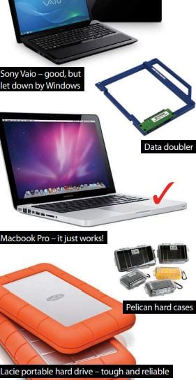

So, PC vs Mac; or in my case a top-of-the-range Sony Vaio versus a 15″ Macbook Pro. If you plan to edit in high definition (HD) I’m afraid a travel-friendly netbook just won’t cut it.
I’ve tested both my PC and Mac to destruction, but when it comes to editing in HD, there’s only one clear winner. In the end what differentiated the two laptops wasn’t the hardware, it was the operating system (OS). Windows for PC, although adequate, proved unreliable, slow and prone to crashing, whereas my Mac just works.
The casing of my Macbook is cut from a solid block of aluminium, and the LCD screen is protected behind a sheet of glass. That solid aluminium body has successfully absorbed the pounding of the road although, I’m afraid to say, I’m now the proud owner of a cracked Macbook screen thanks to potholes on the Linden-to-Lethem road in Guyana. While my PC screen didn’t crack, the body blows it received from the road were eventually fatal. When it comes to rugged design, and despite having a cracked glass screen, the Mac wins the battle.
video-editing
To edit and play video in HD you need sufficient memory in your laptop. I’d suggest a minimum of 4GB RAM, and you’ll soon eat up the hard disk space with all those HD movie clips, so I’d recommend buying a machine with the largest hard disk you can afford. Something that’s easily overlooked is the speed at which your hard disk spins and the rate at which it reads data. Standard hard disks spin at 5,400 rpm. If possible, upgrade to a hard disk that spins at 7,200 rpm. This will help minimise dropped frames when editing and previewing your video. I’ve heard that disks spinning at this speed can be less reliable, so always remember to back up your work regularly.
If you have deep pockets and you’re more serious about your HD video editing the new range of Macbook Pros have Intel Quad-Core processors that I imagine will make short work of playing and editing your video clips. At this end of the market the option to configure your Macbook or Windows laptop with a Solid State hard disk (SSD) is compelling and will no doubt remove the problem of dropped frames when editing. Unlike standard hard disks, SSDs have no moving parts, making them much faster and less prone to failure. SSDs come with a higher price tag and may leave you short of storage in your state-of-the art laptop; the solution? Upgrade your machine by adding a second internal hard disk or SSD using an Optibay Drive Kit from MCE Technologies (www.mcetech.com) or a Data Doubler from OWC (eshop.macsales.com)
Other advantages to the Mac? Mine came preloaded with iLife software. I use iWeb to design and upload the Brainrotting website; iMovie to produce neat travel maps with a line plotting the route from location to location, and Garageband is a great source of copyright-free soundtracks and audio effects.
Portable Hard Disk
video-editing-rugged-esata-2This final piece of hardware will allow you to backup your laptop and store your archived videos. If you’re travelling for a long period of time you’ll quickly fill the hard disk on your laptop so it’s pertinent to pack more than one additional portable hard disk. Having got through a number of portable hard disks to date, only one brand has stayed the test of time, my Lacie Rugged drive (www.lacie.com). If you choose to go with a cheaper but more vulnerable alternative, consider protecting it in a Pelican case which is both tough and waterproof (www.pelican.com)
