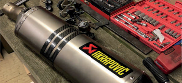

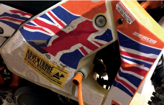

The Akrapovic slip-on silencer saved about a third of the weight, and we swapped the Evo 2 front tanks over from the rally 690 and added the tank shrouds, where the rally fairing used to join the tanks. These tanks hold up to 4.5 litres, but stick out a little, and it’s especially noticeable when stood up. I added a set of long footrests to make this more comfortable over prolonged periods.

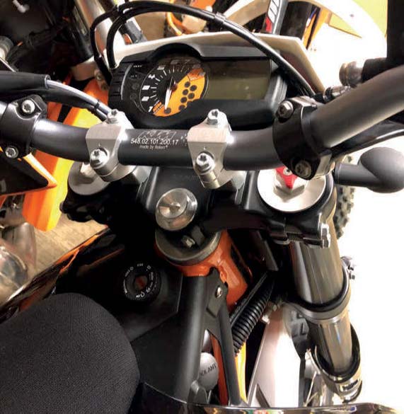

With the suspension and lighting sorted, I then looked at the headstock. I had added some bar risers so that I could comfortably ride for extended periods stood up.
After making these changes, it was time for a test ride, so I did a long loop from Newport to Essex and Norfolk and back, riding through Thetford forest along the way. I noticed that the bike was getting into huge tank slappers every now and then, and it was suggested that I should add a steering damper to counter this. I had always thought they were gimmicks.
I was lucky enough to find a second hand Underground Machine LLC steering damper and combined bar risers on eBay. I added the damper and retraced the 270-mile route again, and I couldn’t believe the difference that it made. It was a huge leap forward, even on the road, with all of the head shakes stopped and the front wheel balanced.
