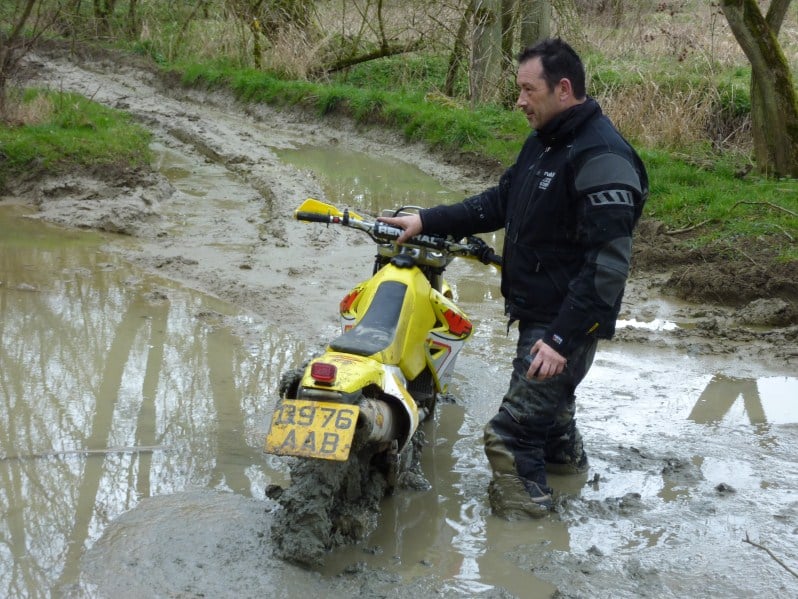

Walk it through first
Generally speaking, there are no secrets or easy answers for a rider wanting to move a heavily-laden adventure bike through mud. However, before you get stuck in, let some air out of your front and rear tyres to improve traction. Just don’t forget to re-inflate them when you hit the road again.
As a general rule, walk it first and if you can’t stand on it, you probably can’t ride it.
Technique can vary from standing up, through to a lot of paddling with your feet as you proceed. Be prepared to take your time – moving through thick mud can be a slow process.
If the mud is not too deep and you can still stand up, use the neutral position. If you feel you are losing traction, then shift your weight to the back of the bike to help the rear wheel grip and drive.
If you are losing steering control, then try to move forward to put more weight on the front wheel, helping it to grip and steer. Ride in a taller gear, keep the revs low, and ‘feather’ the clutch when necessary.
