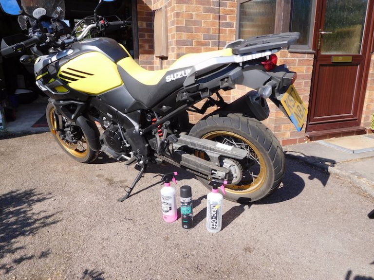

Well-timed question, Michael. I’ve just received a load of Muc-Off gear as a gift and we have a long-term test V-Strom XT 1000 that is due to go back to Suzuki soon. It’s looking very grubby after some spirited use and needs a good spruce up!
First off, you’ll want to get the hosepipe out and give your bike a good soaking to remove the loose stuff and soften up the baked-on crud. I don’t use a jet wash on a road bike, while they are brilliant at getting the worst off, if directed in the wrong places, high pressure water can be forced into past seals and bearings that could cause problems later on, plus modern bikes have far more electrics than the older ones. Water and electricity aren’t the best mix.

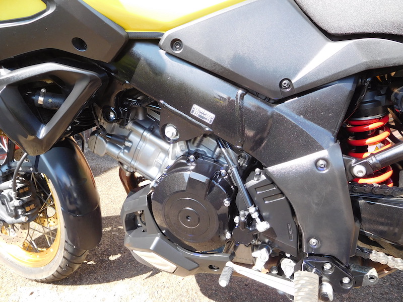

I used the Muc-Off Motorcycle Cleaner on all of the worst places that are hard to get to, including under the engine, rear shock, and swinging arm, as these areas really attract the muck. It works better for me to agitate the dirt with a brush and then use the hose to rinse off. The instructions state not to leave it on too long.

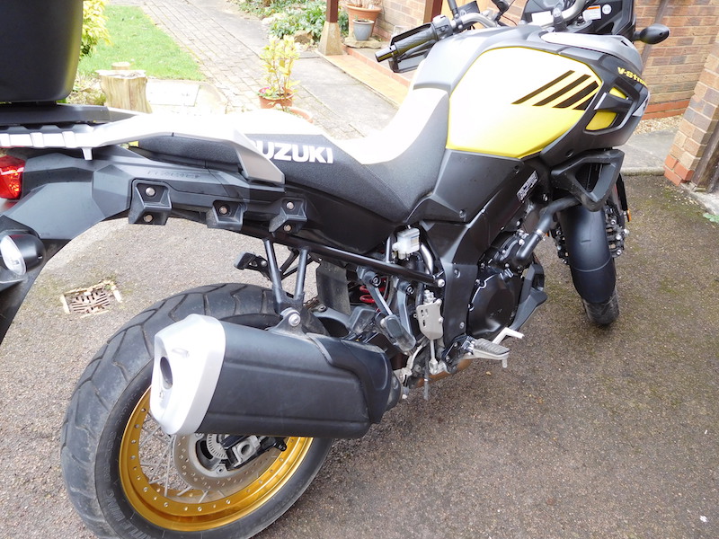

After a good wash off, I leave the bike to dry, then inspect it and find all the bits I’ve missed and start the whole process again. Motorcycles are a real pain to clean, unlike the family barge, which gets an occasional clean at the local hand wash. After I’m satisfied all the crud has been removed, it’s time to apply the Muc-Off after spray. This contains PTFE and not only puts a nice shine on parts, but helps keep fresh crud from sticking, I always coat the underside of mudguards with this product. Obviously, do not get it anywhere near the brakes.

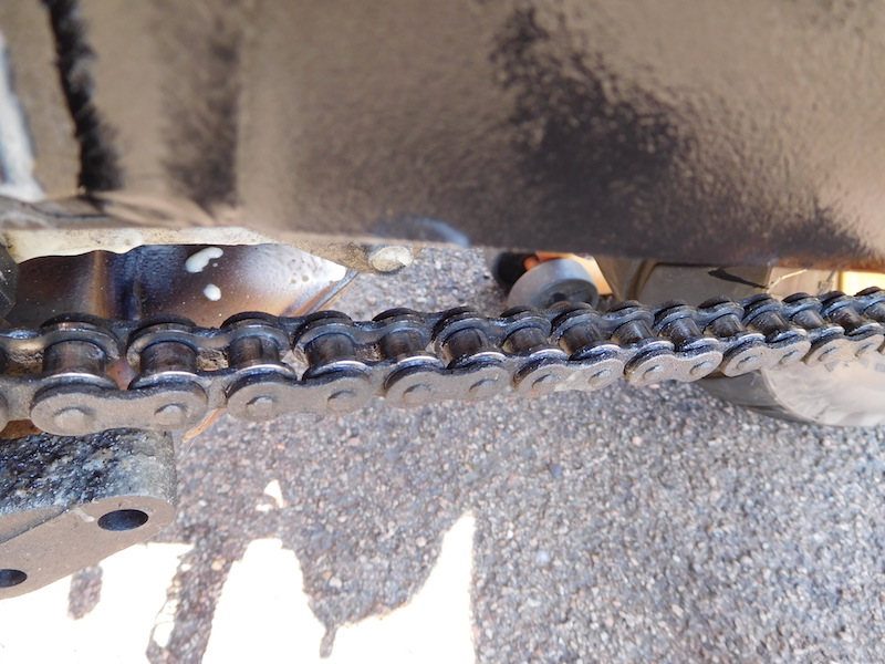

I like to use car polish on the bodywork, both painted and plastic, and it puts a great shine and protects the finish, I have plenty as I never use it on the car! A quick service is now needed, check the levels and tyre pressures and give the chain some needed oil, as it will now be a little dry.
