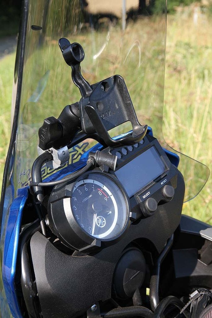

Fitting the lead for the satnav was easy enough as there is a switched power source in a convenient spot behind the main dash. It is actually used for the diagnostic tool at the dealer, but by using some thin connectors you can connect up to it without a problem.

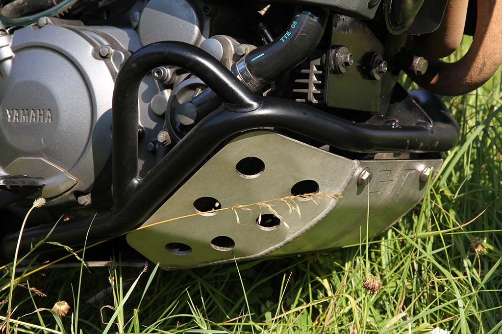

Engine Guard from Adventure Spec:
Well made and simple to fit; essential for rocky trails.

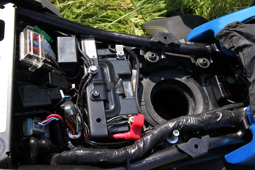

Electrics:
A £5 fuse box was fitted under the seat but the mounting tags needed moulding to fit around the rounded profile of the wheel arch. I fitted a slightly longer bolt to accommodate all the neutral terminals, with one wire going back to the battery to ensure 100 percent earthing at all times. The next step was to make it all switchable so I used a relay that picks its switching signal from the rear light feed, so the positive feed wire from the battery to the fuse box could then be routed through the switched contacts of the relay.

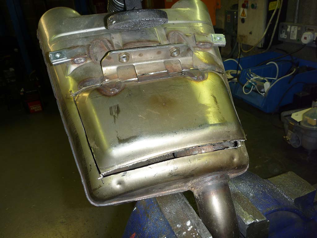

The exhaust is an obvious one to tackle as it has a catalytic converter built into it. To save money I opted to cut out the ‘cat’ and then I used a 20mm holesaw cutter (welded to a long metal rod) to open up the first chamber which would allow gasses to escape directly into the outlet pipe; the seat doesn’t get hot now.

The results? Well it’s not a light switch moment to instant mass power increase, but it has definitely made the bike pull smoother lower down in the rev range and the engine is much more flexible below 3k. Cruising on the motorway, it picks up quicker when the throttle is tweaked to overtake a car. A surprising side effect is the fact that it has improved the fuel economy, which is a bonus!
