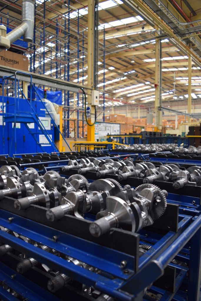

camshafts prior to machining Crankshafts ready to be fitted
Camshafts prior to machining Crankshafts ready to be fitted

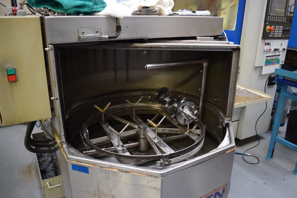

maching-process-issue-23 crankshafts being cleaned
Machining process takes 12 minutes to produce a Rocket 3 cylinder head Crankshafts being cleaned post-machining

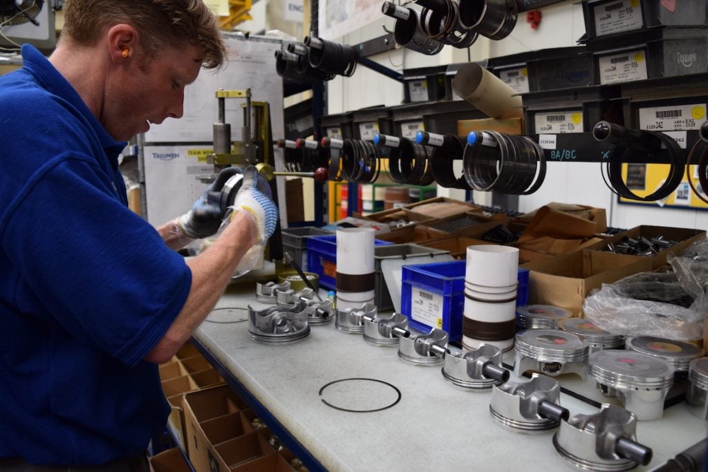

How assembly works is that when a new model is ready for production, it gets stripped down and broken up into five-minute ‘tasks’ or ‘jobs,’ with each man on the assembly line being given five minutes to complete that task. So it might be five minutes to assemble the pistons, or attach the forks, and from the initial engine assembly, the bike goes through the process of bolting to frame, attaching suspension, radiators, pressing in the bearings, mounting handlebars, forks and footrests.
Because of this five-minute production rota, a new Triumph motorcycle, therefore, comes off the production line once every five minutes, with the factory able to build around 130 bikes each day, with a similar number produced in Thailand. The company has the capacity to produce more if demand dictates.
piston-assembly-issue-23 shaft drives hub waiting to be fit
Piston assembly Shaft drives hub waiting to be fit

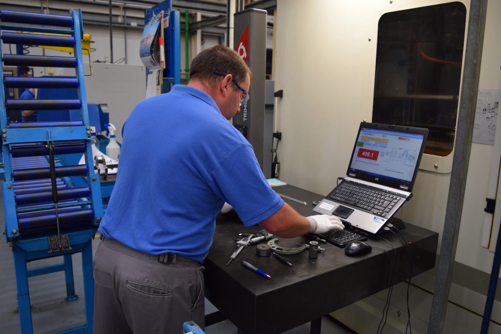

The crankshafts are measured and barcoded so the correct bearing shells can be fitted during engine assembly, with all engines pressure tested to check for leaks before receiving their first oil fill. They are then tested again to check oil pressure, before being fitted to the chassis. In total the engine takes around 45 minutes to assemble, with each model given a unique barcode. It is then scanned as it comes down the line to optimise torque settings for all machinery in the assembly process.
