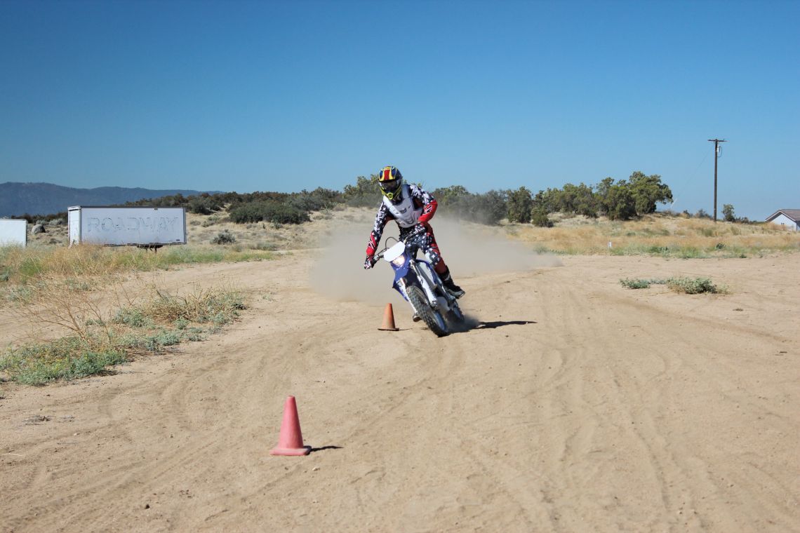

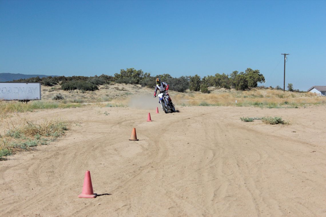

To practice steering with your legs, use a five-traffic-cone slalom exercise laid out on a smooth, dirt straight with a fairly hard-packed surface. Use full-size cones so you’ll hit them if you don’t ride around them. Set up your cones in a straight line approximately 12 paces apart. While riding standing up with your weight forward over the bars, approach the slalom in second or third gear.
As you round the first cone, lean your bike in the direction of the turn and counterbalance your body in the other direction. As you proceed to the next cone, you must shift the bike’s lean to the other direction while shifting your body the opposite way to counterbalance.
At speed, you will not turn the handlebars, just lean the bike left and right. For this exercise, it helps to ride a little bowlegged, let the bike float between your legs and lean from inside of one leg to the inside of the other. At first, you’ll just weave through the slalom course, concentrating on getting your body position correct for each cone.
As you get more comfortable, speed up and try to go through the slalom at a shallower angle. The faster you go, the more shallow the angle will be and the quicker you must shift from left to right. You know you’re going too fast if you start hitting the cones. Be quick with your transitions, proactive not reactive, and don’t get behind. Leaning rearward will tire out your upper body.
Steering with your legs is easy to perform but sometimes hard to feel, especially on slippery days. To get a feel for what it’s like to steer the bike with your legs, it is best to practice it on days when the traction is high, like just after some rain has soaked into the ground. Concentrate on putting pressure onto each footpeg to create the bike’s lean angles.

The slalom
Riding through a slalom course will help you experience steering with your feet and legs and prepare you for sand washes.
The Slalom (1)
1. Approach the first slalom cone standing up at a modest speed and lean the bike in the direction of the turn while shifting your hip and outside leg in the opposite direction.
The Slalom (2)
2. Swap these positions to go around each cone.
3. Next, speed up and try to steer more by shifting your weight, not by turning your handlebars.
The Slalom (3)

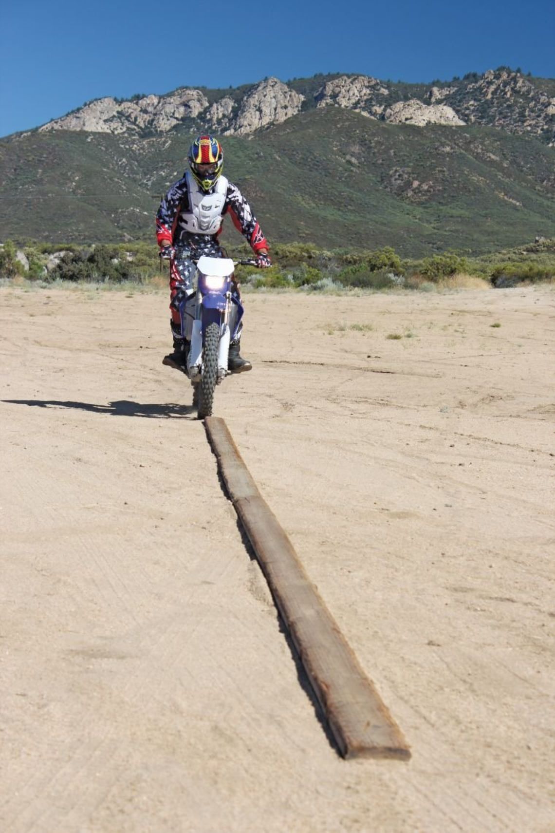

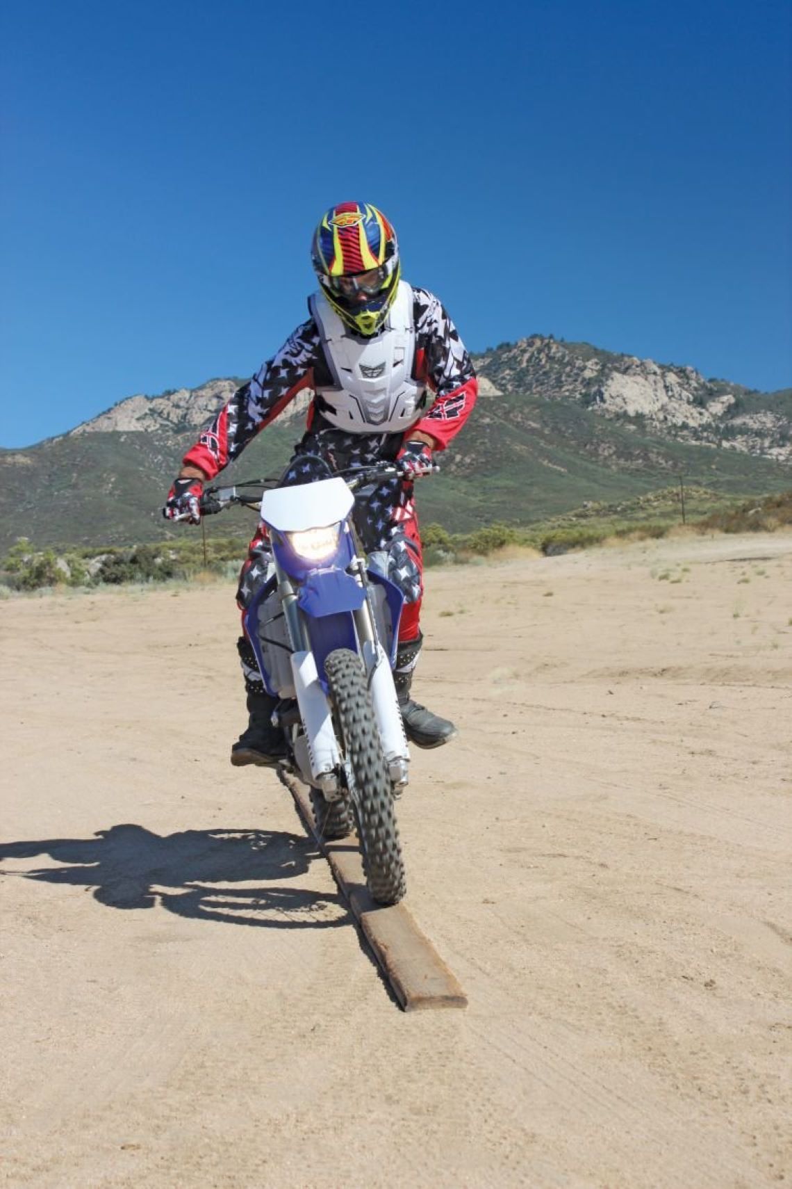

Narrow paths exercise
1. Use a narrow six-inch board about 20-feet long. Ride standing up in first gear, stay as centred as possible, and instead of turning the handlebars to steer it you must rely on leaning it slightly to the right or left.
Narrow-paths-1
2. If your front tire comes off the board don’t try to get it back on from the side, just ride off, turn around and try it again.
Narrow-paths-1

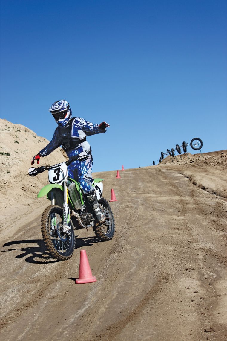

Advanced standing practice
1. A fun way to practice steering your bike with your lower body while standing up is to locate a smooth downhill road like this one and place some markers on it to steer around.
Advanced Standing practice (1)
2. Start by picking up a little speed with the bike in second gear, then release the throttle and gradually decelerate as you stand up.
Advanced Standing practice (2)
3. To steer it you may have to press your legs against the bike, and of course always be ready to grab the handlebars if you feel out of control.
Advanced Standing practice (3)
