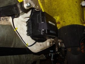

The seat is a widow-maker, like all Enduro bikes. It went straight onto eBay and a Corbin was picked up. This made 200-mile days easily doable with 300 as its limit. Being the ‘S’ model it was also afflicted with a load of Euro emissions junk. Off came the PAIR valve and carburettor-restricting solenoid and in came the Scorpion exhaust system, jetting kit and air-box enlargement. To make the bike more suited to covering long distances, I fitted a larger 15l plastic fuel tank. I also put on some higher Renthal Dakar High handlebars for a more upright riding position. I melted a sheet of Perspex in the oven to fit as a wind shield and fitted a larger battery out of a Honda Fireblade to add extra starting amps.

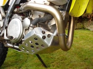

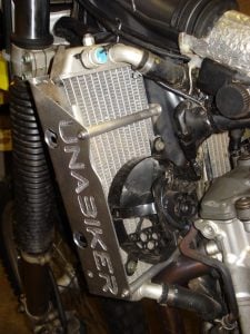

The online meccas for DRZ400 ownership are www.drz400uk.org and www.thumpertalk.com. It was here that I learnt about the few weaknesses the DRZ has. Luckily they’re easily dealt with. According to talk on the forum, I quickly deduced that the radiators are proven to be fragile, so UNIBIKER radiator guards were quickly imported. The engine cases also seemed to be made of a soft-cheese variety of aluminium so stick-on covers were next on the list. As I was getting all protection orientated, I also picked up a beefy bash plate and hardcore hand guards. An oversight at the factory means that the alternator and ignition pickup bolts are prone to rattling loose so these had to be thread locked. Then it was job done and I was ready to roll.
