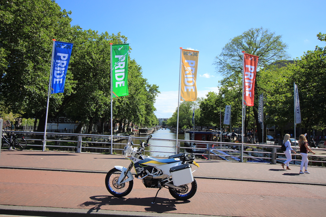

The finished product
While simplicity and strength are vitally important to ensure that the bike can cope with the rigours of tough riding, the guys acknowledge that weight makes adventure touring hard work, and so they’ve tried to keep the end result as lightweight as possible. They can attach auxiliary fuel tanks, massive aluminium boxes and lots of steel crash protection if you want them to, but Aad and Mike really try to down-sell you in the interests of your on-trail enjoyment.
It’s not the best business practice, but it leaves happy customers with relatively light and nimble bikes. The additional fuel tanks can, of course, be vital when touring through isolated regions, but when I told the men where I was intending to ride (mostly in mainland Europe), Aad rolled his eyes and told me not to bother! I felt gently put in my place for trying to be unnecessarily rugged!
At the core of the Adventure Tower design are wind protection and a home for your GPS. The construction is of aircraft-grade aluminium, and the entire nose cone is bolted together rather than welded. The reasoning for this? If anything breaks it can be replaced using a spanner and socket.
Mike and Aad are 21st Century boys, and the tower has Ram Mounts and USB electrickery throughout, drawing on an ignition feed that’s wired via the rear light to avoid straining the adequate, but not magnificent 300w alternator of the 701.
A cornucopia of power sources can be attached to the Adventure Tower, and so I decided upon the standard Ram Mount, two USB sockets and four switches (for headlights, which replace the adequate but not fantastic stock lights, auxiliary lights, and a heated jacket – and I kept the fourth for, well, symmetry. Three would look silly.). For tech junkies and YouTube heroes, there’s room for five Ram Mounts.
So, with the addition of the rally screen, a big old nose cone and some superior luggage has the long-lost Holy Grail of a sub-150kg off-road capable adventure bike, that can cruise at 80mph without pulling your head off, been found?
