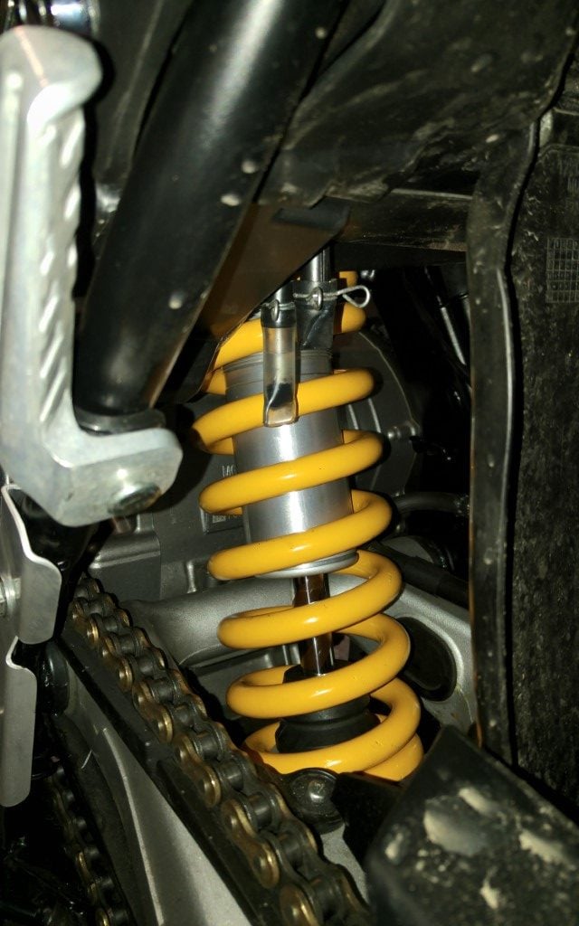

With the simple basics of the engine swap completed I turned my attention to the upgrades that the bike needed. The suspension is simply not up to the task (especially when you factor in my love of beer and any luggage I would carry!) so I went to the best – Öhlins for the shock, and US specialists, RaceTech, for the fork upgrades.
Both were customised to my weight and riding style and, to call the differences ‘night and day’, is to massively undersell the change to the ride.
new suspension
Ohlins suspension
The CRF went from a soft, wallowy budget bike into a very capable dual sport performer, poised and controlled on-road and plush yet responsive in the dirt. This was the second biggest improvement to the bike after the engine swap and, if you have a CRF, I can’t recommend it highly enough.

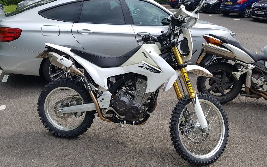

I had a custom exhaust header fabricated and used a £30 eBay end can which, amazingly, turned to be just the right mix of quiet and throaty, a real steal. One thing that the custom exhaust changes is the sump, a new one needed to be made, utilising all the space left around the exhaust and it needed to be slimmer than the frame to keep ground clearance as high as possible.

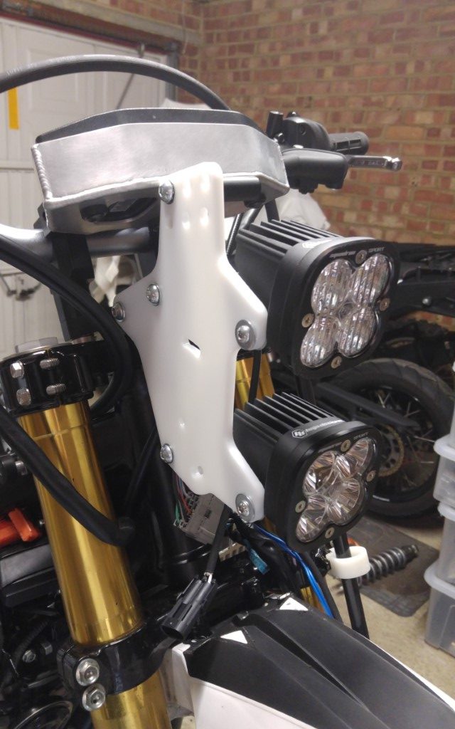

Probably to most visually obvious change to the bike is the rally fairing. I really wanted to use Highway Dirtbike’s brilliant handguards and flip out mirrors and, while ordering those, I saw their lightweight HDPE rally fairing.
The unit is fantastically light, holds my Baja Designs Squadron lights and gives really good protection and clean air when riding at speed on the road. I know some don’t like the looks of the fairing but I have grown to love its simple form and brilliant function. As an added bonus, there is a significant weight saving high up on the bike.

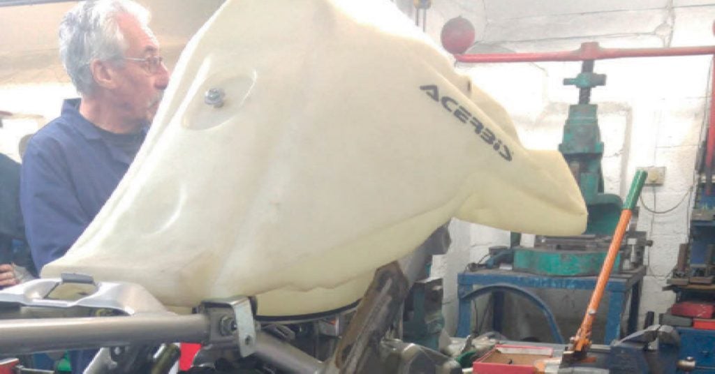

Other additions to the bike include a 12.5-litre Acerbis tank (gives about 200-mile range), a Seat Concepts high seat, heated grips, Garmin Montana powered mount, Zeta frame guards and levers and tail tidy. All of the changes I have made are designed to either improve performance or reduce weight and those were both big factors when it came to the last major custom part – the bash plate.

The final bike is exactly what I was looking for, it’s brilliant to ride off-road and great fun and powerful enough on-road – the perfect dual sport bike? I think it might be.
