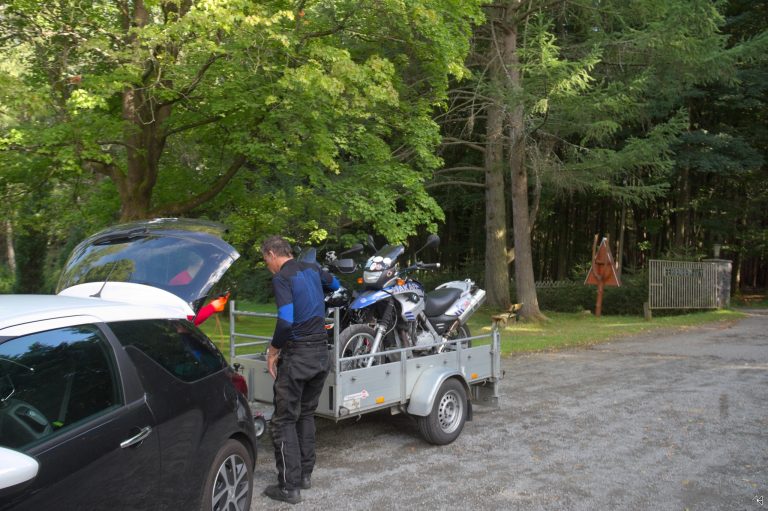

Two BMW motorcycles are loaded and tied down on a brand new motorcycle trailer
So far, so obvious. But hands up who knows what nose weight is? Extra points if you know what your nose weight limit for your car is, and top-class if you can actually measure it!
Nose weight is the static downforce generated at the hitching point by a towed or otherwise affixed load onto the tow bar. It is second only to the weight ratio to the tow load to the tow vehicle (which should not exceed 85%) as a safety factor, and the heavier the load, the bigger the nose weight needs to be. If it’s not, traction in the rear wheels will be compromised and the trailers could snake, causing an accident.
Nose weight is crucial to safe trailering. Once you know the nose weight of your car (it will be in your owner’s manual), you can work out the ratio of the rate to the tow vehicle to the towed load. For example, if you have an un-braked trailer (and just about every bike trailer will be un-braked), a Ford Focus Zetec 1.6 has a range of safe towing loads, depending on the model, between 300-625kg. Going beyond the manufacturer’s limits could easily constitute a dangerous driving charge if your trailer gets bent out of shape as a result of such actions.
Unfortunately, if you want to check if you are safe to tow, you are going to have to do some homework. You’ll need to know your tow vehicle’s limit for towing an un-braked trailer, the manufacturer’s published nose weight, the gross vehicle weight of the tow vehicle, and ensure the towed load does not exceed 750kg or the manufacturer’s maximum if lower on an un-braked trailer.
Also, the lighter your motorcycle trailer, the less crucial downforce/nose weight becomes. If you are towing a 750kg load behind a 1.1-tonne car, the load is about 68% of the weight of the towing vehicle. If you do not have weight pressing down through the towing hitch when the trailer bounces the static force that goes through the hitch starts to vary. Three-quarters of a tonne pulling 1.1 tonnes is clearly going to start lifting, even momentarily, the tow vehicle’s suspension, which means that your back wheels are more likely to break out, leading to snaking which can bend your vehicle out of shape and is the reason why you see cars on their roofs in the summer holidays as people are towing caravans without making these checks.

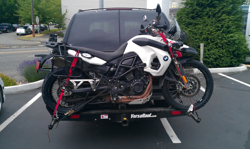

A BMW on the back of a car

Finally, a word on racks. I have seen enduro bikes on the back of family cars and MPVs, even the ubiquitous VW T5 will have a dirt bike perched on the rack on the back. I own a T5, so I happen to know the maximum nose weight for my model is 80kg. I have a rack, which I know weighs 9kg, therefore if my bike weighs more than 71kg I cannot put it on a rack on the back of the van.
I’ve seen 160kg bikes on the back of a Renault Espace, with the front wheels virtually pawing the air and the rear suspension sat so low that the tyres are pretty much touching the arches. That was a crash waiting to happen, and any copper worth his salt will have that vehicle over and have the driver nicked.
Once you make the decision to transport your bike to the dirt in anything other than the back of a van, you need to do some thinking and research. Hitch and hope might work, and probably for a single dirt bike on a trailer you’re unlikely to go wrong, but a bit of homework will keep you on the right side of the law.
