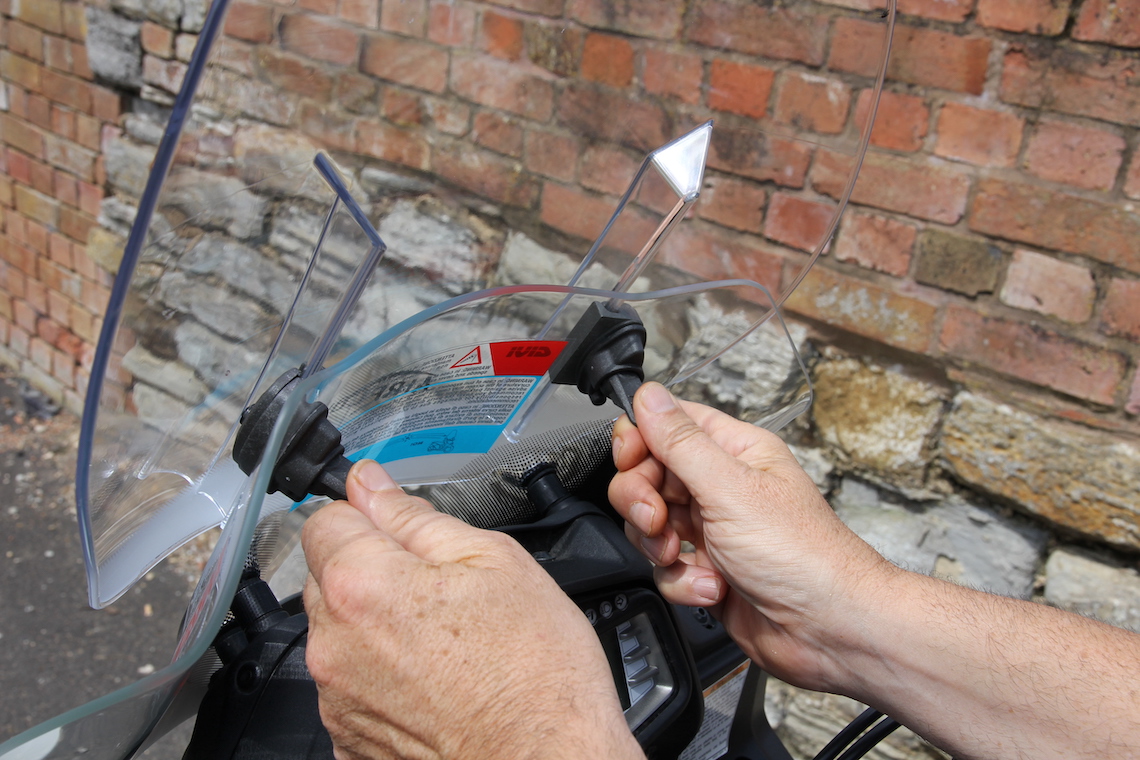

The Givi Airflow screen was easy to fit, and also easy to adjust, though it does take both hands to do so.
On a scale of 1 to 10; where 1 equals behind the screen bliss and 10 represents having your eyeballs sucked out by a tempest, the Suzuki V-Strom 650 is about a 5, which means the designer is probably taking his tablets but needs to up the dose. That said it would be unfair to single out the V-Strom 650 as an inducer of tornadoes because there are far, far worse out there, the old Triumph Tiger 955i being one that thunders, literally, to mind.
Anyway, I’d been told that the cure-all for the 650 Strom was the aftermarket Givi Airflow. The Givi is taller and wider than the original Suzuki screen and comes in two sections (the stock screen is a single slab of plastic) and has a sliding height adjustment of just over 6in. And the best thing about fitting this new screen is that even a reluctant bodger like myself can have the old one off and the new bit of plastic in situ within two minutes.

The original V-Strom screen has three fixing positions – low, medium, high – and adjustment is via four fixing screws.
The Givi slots straight into any of these positions, which coupled with the adjustment range of the screen itself offers the rider a huge range of potential heights.
Take it from someone who’s squandered plenty over the years on aftermarket screens with no adjustment this is a major benefit and every shape and size of the rider should find a position where comfort is acceptable.
With the Airflow attached to the highest fixing points on the bike I hit the road with the screen set at its lowest position and was rewarded with an instant improvement over the stock shield. Cruising at 70mph was a pleasure with reduced wind noise and little to no turbulence. The highest setting impaired my vision (I’m 6ft 2in) however bliss was found when I lowered the screen to about 2/3 height where wind noise almost disappeared, turbulence was non-existent and visor-up riding a pleasure. Plus, there was a pleasant flow of cooling air at around chest height, just the job for the warmest day of the year so far.
The screen fits the 650 Strom perfectly and does not interfere with the handguards or mirrors, even on full lock. Style-wise it’s not the grotesque-looking carbuncle that some aftermarket screens can resemble, but it’s no sleek glamour model either.
The sliding adjustment mechanism on the Givi Airflow is simple to operate, but not one you’d be advised to do whilst riding. Another feature which I like is that it is safe to ride with the upper screen removed completely. This will appeal to riders who’ll only want to use the second screen for touring. They’re not cheap – web prices are around £130, but they can transform the level of riding comfort and are custom made for most adventure bikes.
