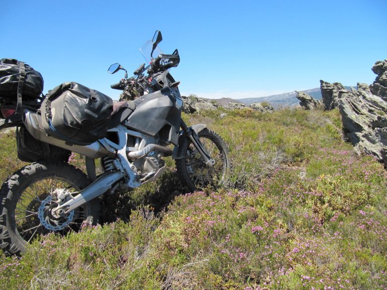

On the trails we covered quite a mixed bag of terrain, and as you may expect the bike was very good. The rear suspension coped extremely well with the weight of the luggage. I was chugging along here and there and hit long rain-ruts and general trail stuff pretty fast. The bike tracks very well. I couldn’t detect any deflection and the chassis and suspension just ate up the bumps and cambers. No way would I dare to ride this fast on my Yam XT660.
It’s probably a less plush ride than the XT or KLR going slow as it’s set a little harder, but increase the pace and where the XT uses up its suspension tokens the CCM remains poised on fast trails. The pegs, handlebars and tank design are pure dirtbike when standing. The faster I went the smother it seemed to get. I got a bit of air on a few occasions which, believe me, is not usually my style at all.
I rode a bit of rocky stuff and several very steep climbs. The suspension just helps so much and the drive is so linear. You can get right up over the handlebars, leave it with a steady throttle and it just tracks, grips and climbs impressively well. Even going over some big deflections it just drove up. The other thing I’d say is that because it’s so light I wasn’t so concerned if I lost my way shall we say!
When I did get in trouble I could turn the CCM around on my knee with full luggage fitted; bliss. The CCM generally went in front 100 meters to check out the terrain, with the guys on the other bikes following behind. The bike was manageable in real awkward spots, and in this sort of terrain, it is difficult to fault.
