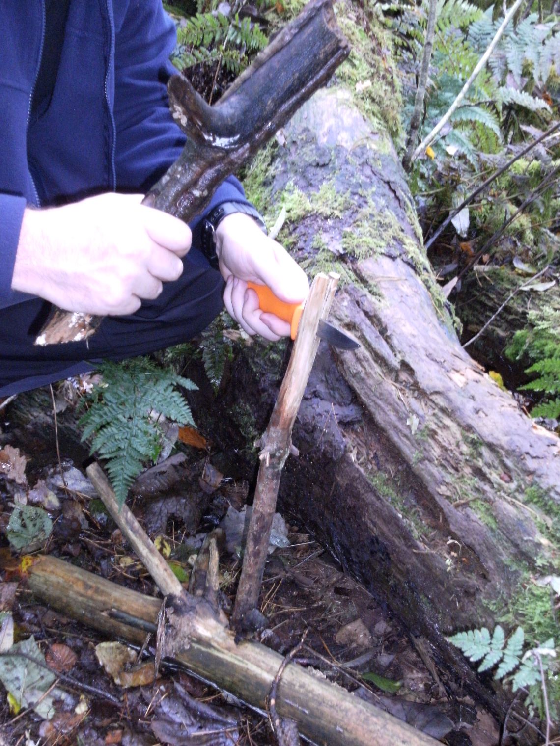

The basic grip on a knife is the forehand grip with the knife held so that the blade rises from between thumb and forefinger with the edge away from your body. The backhand grip, used for some power cuts such as the chest lever cut, has the blade edge pointing back up your arm.
safe-cutting-backhand-power-cut
Backhand Power Cut

Knife hand stays still and the wood is moved

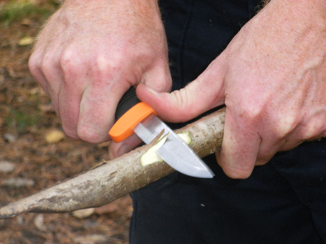

Left thumb assist cut

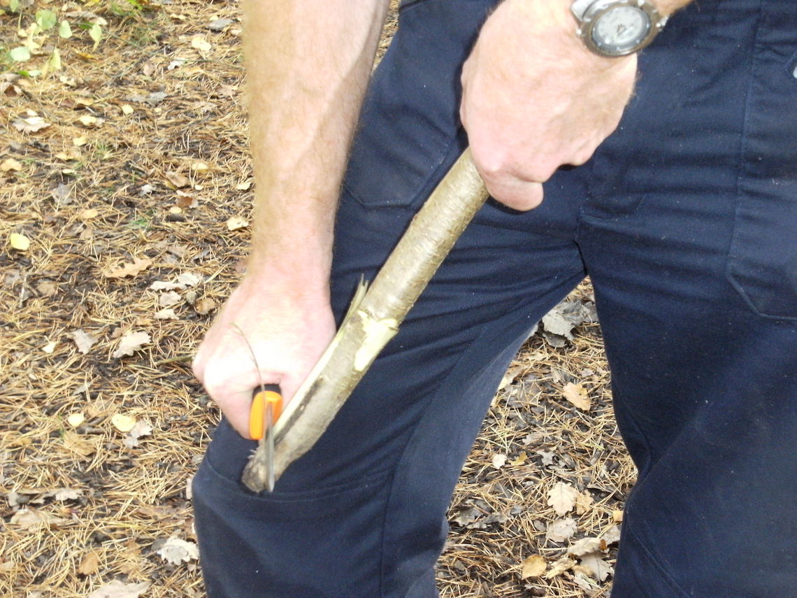

The forehand cut is the instinctive cut you would make to, say, sharpen a pencil, and is probably the most used. The drawback of using this cut is that a lot of energy is lost in the follow through after you’ve cut through the intended materials, and can cause accidents.
It is possible to improve this cut by locking your knife hand against your leg or knee and pulling the work onto the blade – no swinging blade to worry about! It may sound awkward, but if practised it will eventually become natural.
To make controlled cuts for cutting a branch to the point it can be broken, notching or shaving wood, then the thumb assist is a good safe cut. The thumb of the hand not holding the knife is used to put pressure on the back of the blade, helping control the cut. Do this all round a branch and it will thin it for breaking, or multiple cuts can make feather sticks for burning, clear a notch or do other fine shaping.

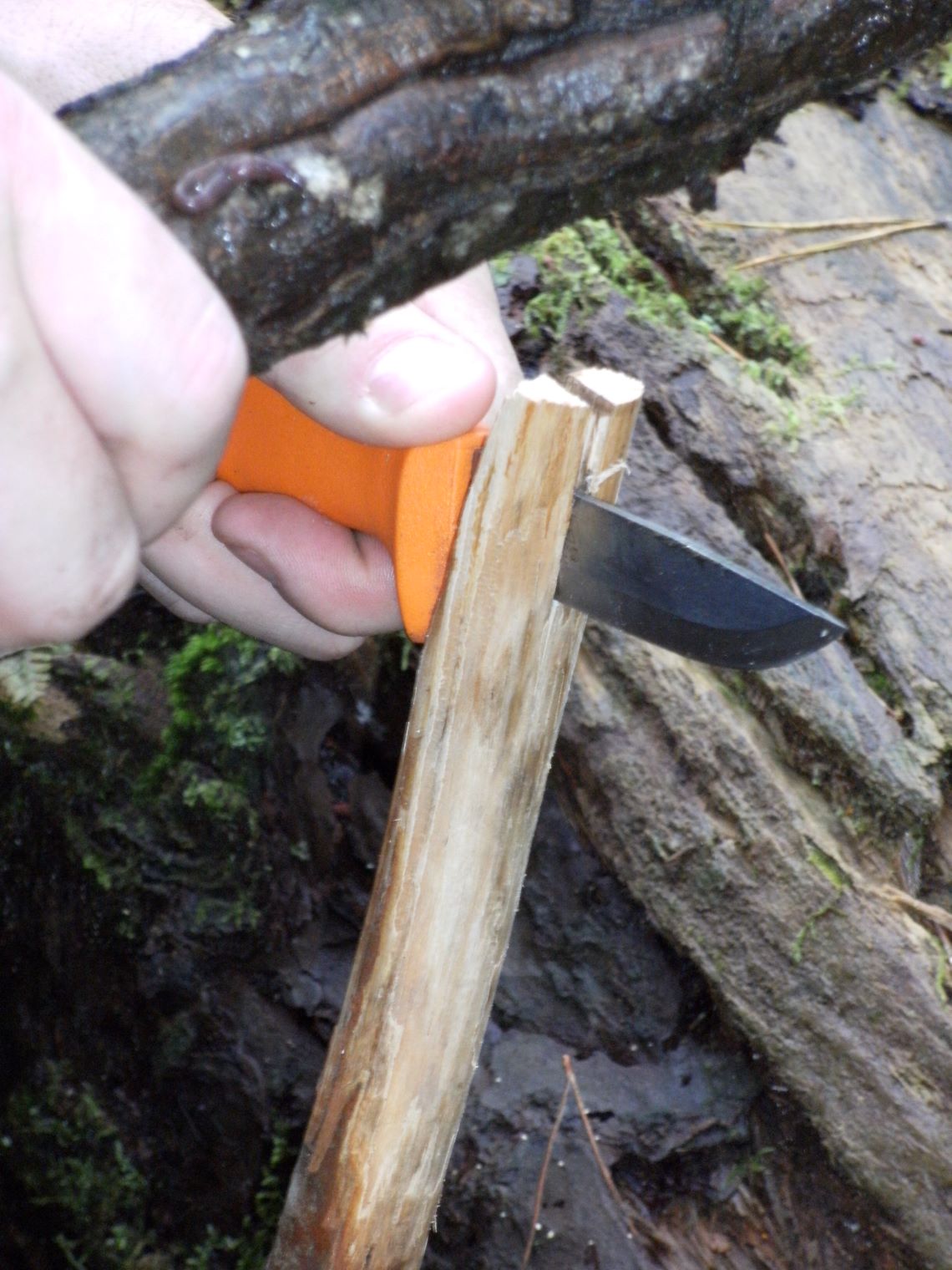

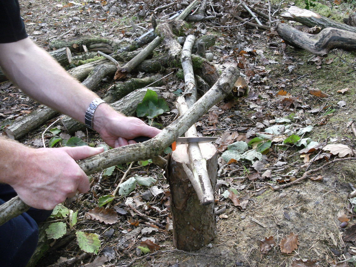

Most cuts work best at an angle along the wood grain, but if you need to make a 90-degree cut, then batoning is the answer. To do this, place the work to be cut on a firm cutting platform and place the knife on the point to be cut through. Then, with a baton stick, tap the back of the blade until the wood is cut. To make a notch, baton the knife in to the required depth, then cut down to clear the notch with a thumb assist cut. Batoning can also be used to split wood along the grain to expose dry wood for fire-making, for instance, and rough shaping of large tools.
Timber!
To split a branch, place the knife in the position you want on the end of the piece of wood and rest the other on a firm support. Have the knife guard close to the wood and tap the blade down with a baton. As the blade sinks into the wood, you can use the baton on the exposed end of the blade, keeping pressure on the handle to prevent the knife tilting too much from the level position.
If you’re cutting a large piece of wood, rather than beat your knife all the way down, you can baton cut a good depth, then use whittled wedges inserted into the cut to split the wood apart, thus saving wear and tear on your knife and any possible accidental cuts.

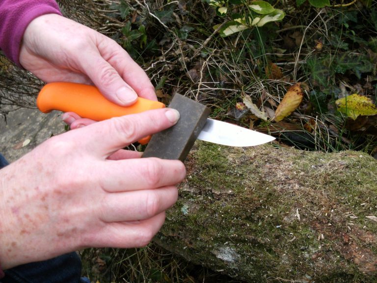

A sharper knife is a safer knife. It will cut cleaner, with more control and with less effort, thus reducing the likelihood of slips and accidents. A sharper knife also makes a cleaner cut if you do have an accident and I can report that a clean cut hurts less and heals faster than a ragged cut from a blunt knife. Trust me on this.
You should carry something in your bug-out bag to sharpen your knife with. A tungsten carbide sharpener is good. I prefer a small sharpening tool, butchers steel or whetstone, though in desperation any flat, fairly coarse stone, bottle or even flat piece of wood can be used.
With a sharpening stone you can use one of two methods:
  1. Fix the stone to a surface and run the blade down it as if you were trying to slice a fine sliver off the stone. Do this on one side until you can just feel a small burr developing on the other side of the edge; then turn the blade over and cut the stone for an equal number of strokes. Remove the burr by stropping it on smooth wood, the side of a bottle or on leather. Stropping is achieved by pulling rather than pushing the edge against the leather, wood or glass, but keeping the same angle as when sharpening.
  2. Hold the stone in one hand, the knife in the other, and rub the stone along the edge in a circular motion from guard to tip. Continue ‘drawing’ several circles along the blade as you work along the edge. Do this both sides until the edge is sharp (the burr would be removed as you work with this method)
