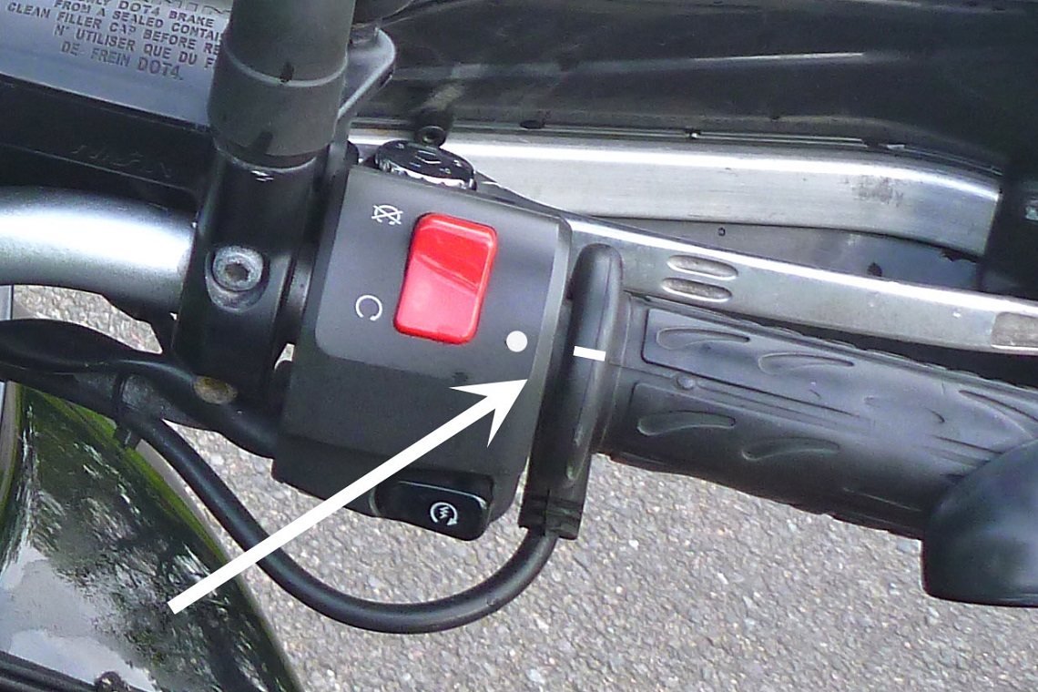

Other ways of saving fuel include running radial road tyres and minimising the frontal profile of your bike. Overtake smoothly, brake moderately and maintain a steady momentum. If you have a choice, avoid the lowest-octane fuel; I’ve found it’s a false economy. When desperate, coast down long descents at tick-over in neutral (while remembering that brakes may overheat). I also mark the throttle position to tell at a glance how wide open it is. Against a headwind or gradient the throttle can creep open; backing off a few mph can save a lot of fuel.

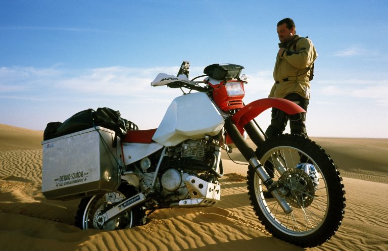

Finding fuel
Finding fuel in the middle of the desert isn’t easy
In Britain, we’ve long been strapped because aftermarket tanks from Acerbis, Clarke, IMS and Safari are costly. But once you get over that, a replacement tank has the minimum ergonomic impact on your bike. It’s designing a durable roto moulded tank to fit well which costs. Nevertheless, paying 500 quid to gain seven litres is what compels riders to find other solutions.
Mark your throttle
Mark your throttle

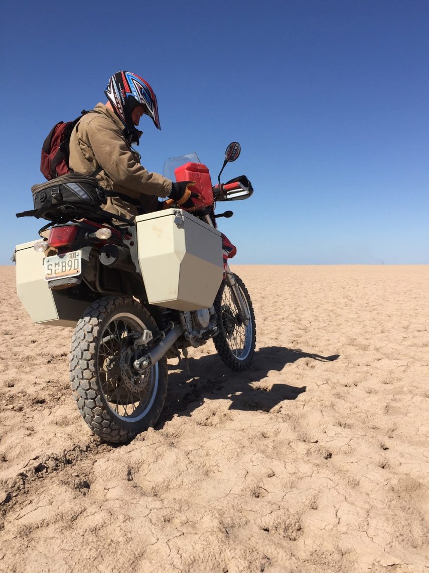

Simple Fuel Storage
Simple Fuel Storage
Remember: huge tanks sit midway, so upgrade the suspension on both ends, not just the front. Underseat tanks on some BMWs and Hondas are hard to enlarge, but as I learned on my XCountry, attaching the fuel-pump vacuum tube created a seamless syphon from something like an auxiliary X Tank (from Hot Road Welding). Range rose to 220 miles with no extra pumps or taps needed, but at quite a cost. Consider a similar arrangement for your under-seat-tanked bike as it’s such an easy job.
Demountable containers
This is the cheapest solution: a 5.7-litre can for my 7-litre-tanked KLX250 was just $20 (£14) from Walmart – a lot less than $275 (£190) for an IMS tank gaining 4.2 litres. For £11 Touratech sell two or three-litre cans which mount with a Touratech bracket onto your Touratech box, though I’d say less than three litres isn’t worth it except to stash unleaded fuel for temperamental petrol stoves.
Well-known Rotopax storage cans (most usefully: 3.8, 6.6 and 7.5 litres) mount securely but get pricey with the added hardware. The clever central locating hole also constrains the flat sides from ballooning out as petrol expands due to heat and shaking. That’s why traditional steel jerrycans have that ‘X’ stamped in the sides.
Rotopax may cost 10 times a regular Halfords can, and take up a lot of space for their volume, but that doesn’t stop US riders clamping them all over their adv rigs. Traditional steel jerries are cheap, robust and make good bike stands and seats. On a bike, the 10-litre slim version (from £15) works best.
As well as plastic cans, fuel bags are now legal, from use-once five-litre jobbies to rugged vinyl bladders as big as you like. They take little space until you need them, but, being wobbly blobs, can be hard to secure. Liquid Containment in Australia do 10- or 15-litre ‘touring cans’ for about £60.
Beware Chinese copies, but I’d take one of these over the same capacity in Rotopax. In dire straits, many of us have resorted to plastic Coke bottles found by the roadside.
