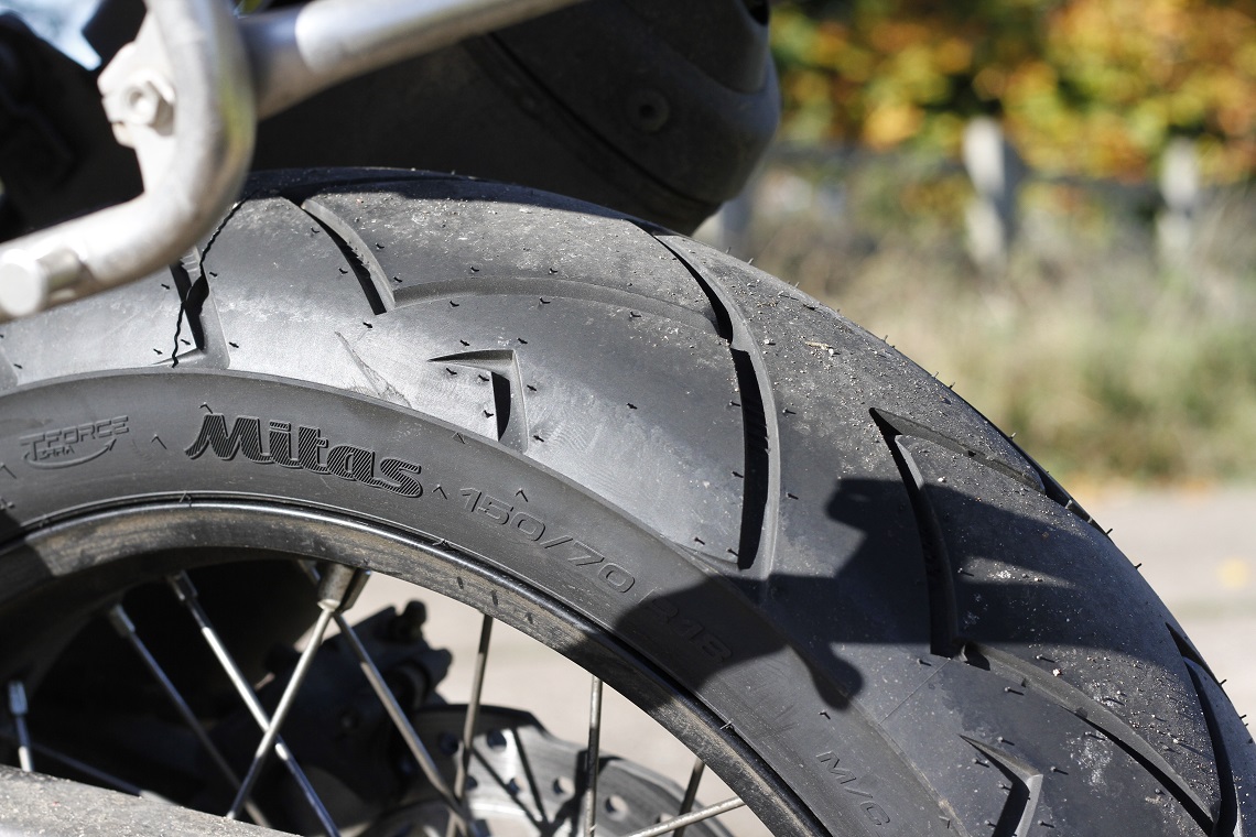

However, making your rubber as grippy as possible can compromise on the life of a tyre. That’s not ideal if you cover long distances with any regularity, which is why Mitas has used two different compounds in the construction of the Terra Force-R.
Stickier rubber is found on the shoulders (the edges you use when cornering) to provide that gum under the table grip when you’re leaned over, while the central strip is formed of a more durable compound. The result is to keep the tyres from squaring off, ensuring a long life. So far, wear is looking even, and a trawl of adventure biking forums suggests that an impressive 10,000 miles on the rear is par for the course.

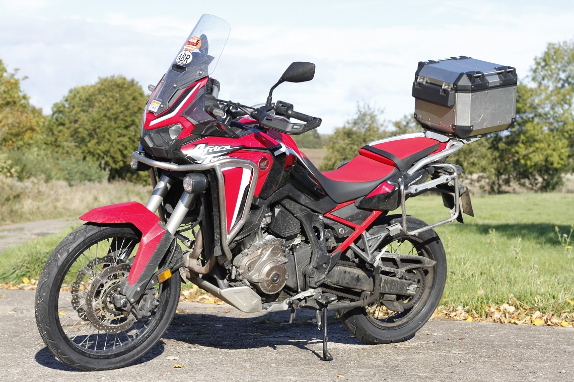

clad in Mitas Terra ForceR tyres
Ollie’s Africa Twin clad in Mitas Terra Force-R tyres
