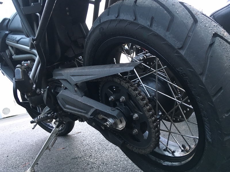

Inspect it
Try getting into the habit of looking at your chain every time you ride, keeping tabs on how dirty it is, on any rust spots that may have appeared (a sign lubrication is needed) and how much play there is in the tension.
A regular check will allow you to spot issues early and carry out the maintenance needed to give your chain and sprockets a long and happy life.

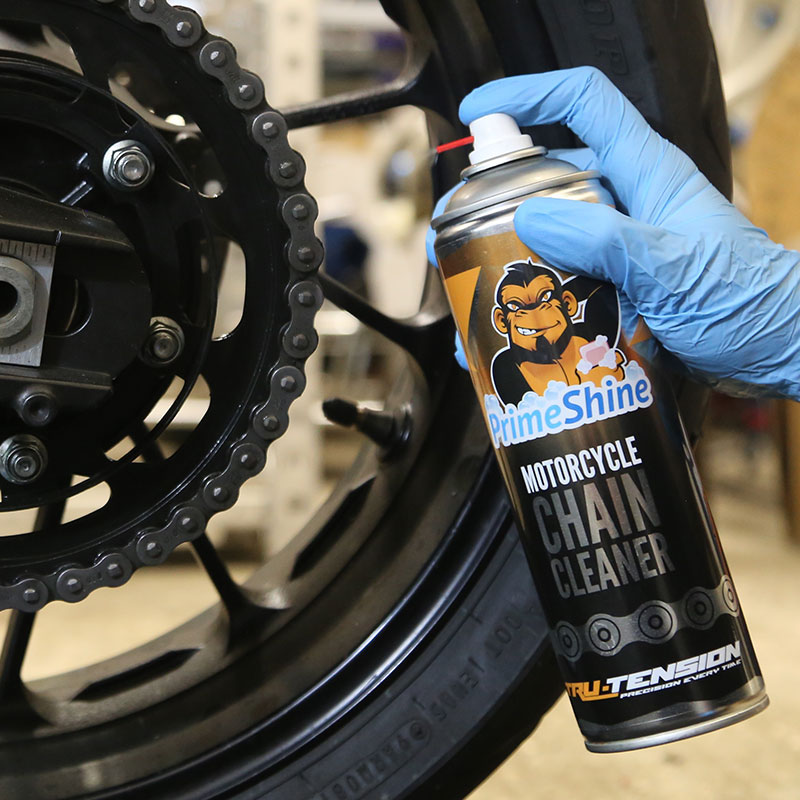

Clean and lube it
Always ensure you clean your chain before lubing it. Put your bike on its centre stand and make sure it is in neutral. Place a piece of cardboard or similar behind the chain to catch any excess cleaner.
Next, spray your chain with a specialised cleaning product like Tru-Tension’s PrimeShine chain cleaner, while spinning the back wheel. Then take a brush and scrub the chain clean. Next, wipe down the chain with a cloth to dry it and also wipe away any dirt and crud on the rear sprockets.
With your still bike on its centre stand and the piece of cardboard still in place, spray your chain with a specialised motorcycle lubricant, aiming for the overlapping portions of the chain links on the lower rung, as you spin the rear wheel with your right hand. A couple of revolutions of the chain will do fine.
If you don’t have a centre stand, do the same as above but one section of chain at a time, moving your bike forward to rotate the chain. It’s a little more time consuming but the result will be the same.
