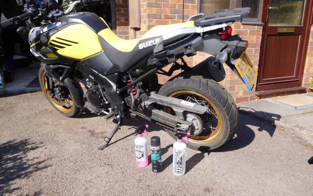

Well-timed question, Michael. I’ve just received a load of Muc-Off gear as a gift and we have a long-term test V-Strom XT 1000 that is due to go back to Suzuki soon. It’s looking very grubby after some spirited use and needs a good spruce up!

I used the Muc-Off Motorcycle Cleaner on all of the worst places that are hard to get to, including under the engine, rear shock and swinging arm, as these areas really attract the muck. It works better for me to agitate the dirt with a brush and then use the hose to rinse off. The instructions state not to leave it on too long.
After a good wash off, I leave the bike to dry, then inspect it and find all the bits I’ve missed and start the whole process again. Motorcycles are a real pain to clean, unlike the family barge, which gets an occasional clean at the local hand wash.
After I’m satisfied all the crud has been removed, it’s time to apply the Muc-Off after spray. This contains PTFE and not only puts a nice shine on parts, but helps keep fresh crud from sticking, I always coat the underside of mudguards with this product. Obviously, do not get it anywhere near the brakes.
