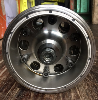

gspod wrote:TI'm no mechanic, but as it runs in oil surely that would dictate the running temperature. Be interesting to check any high mileage 2013s on. I hope the rewind lasts longer than yours
Nope the stator is air cooled or via heat transfer to the casing.There a thread I read recently Ill see if I can find it but basically the early version was a poor design {i have the 08 with 55K]
EDIT Cant seem to find it but this talks the same subject
http://advrider.com/index.php?threads/h ... ly.685465/
http://advrider.com/index.php?threads/f ... e.1133176/
New stator magnet with holes where the older version is solid

OLD VERSION
NEW VERSION
NEW VERSION with ceramic coating on windings
If you can find a second hand flywheel from a 2012 - present day it will fit and cure the overheating issue

Either get the stater changed or checked out as you are almost up to the mileage where they go.
We had one on a US trip this year and luckily it went on the last day so we recovered it straight back to teh container to ship home. The AA recovered it back to Sheffield this end (thumbs)

Thanks for all the info on the stator. Will try to get 10K out of the rewind and then look for a secondhand fly wheel
