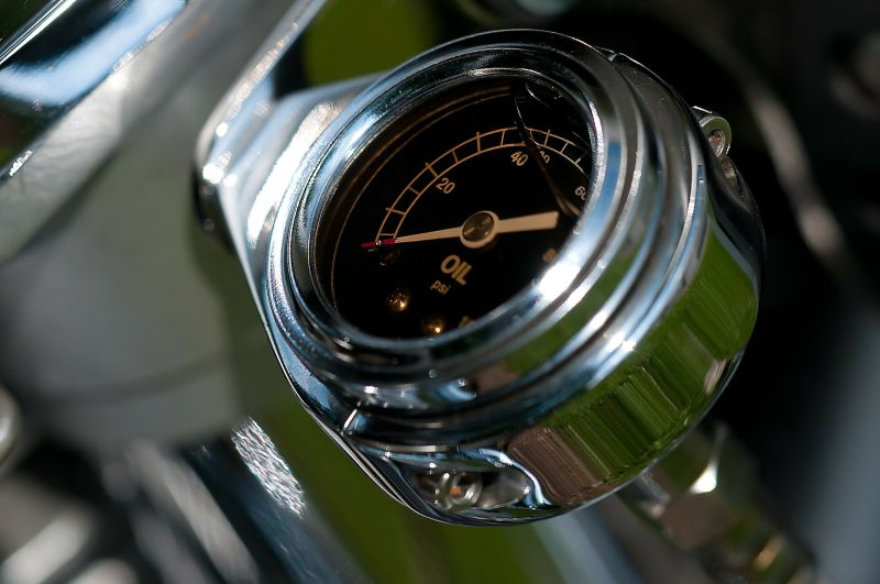

Change the engine oil
Oil gauge motorcycle
Generally we need to change our engine oil every 3,000 miles or so (depending your riding style), and it’s crucial that we do so to ensure the engine operates smoothly and efficiently. Make sure you regularly check the engine oil level and also check for any leakages.

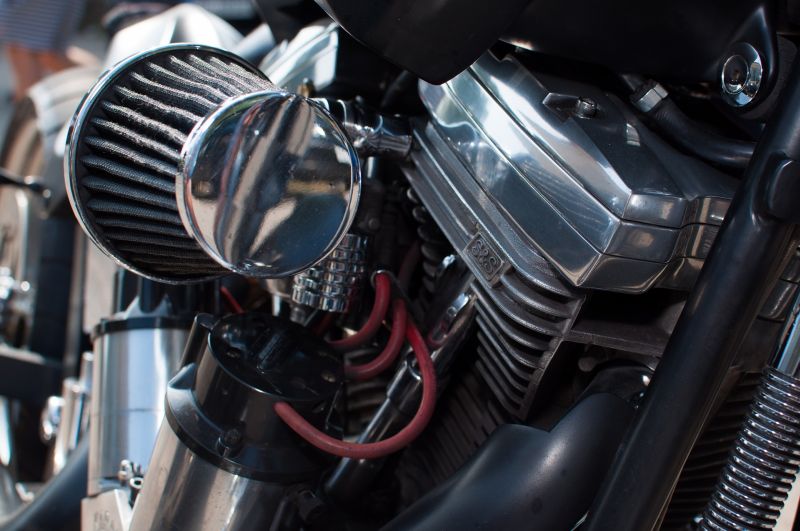

A breath of fresh air
Motorcycle air filter
The air filter is an important component of your motorbike. Its job is to act like a shield to help protect the engine from dust and debris. All sorts of crap gets sucked up in there, so you’ll want to keep an eye on it at regular intervals and clean when needed. How often you need to clean it will all come down to where and how often you ride, so make sure you keep an eye on things and clean when you feel appropriate.

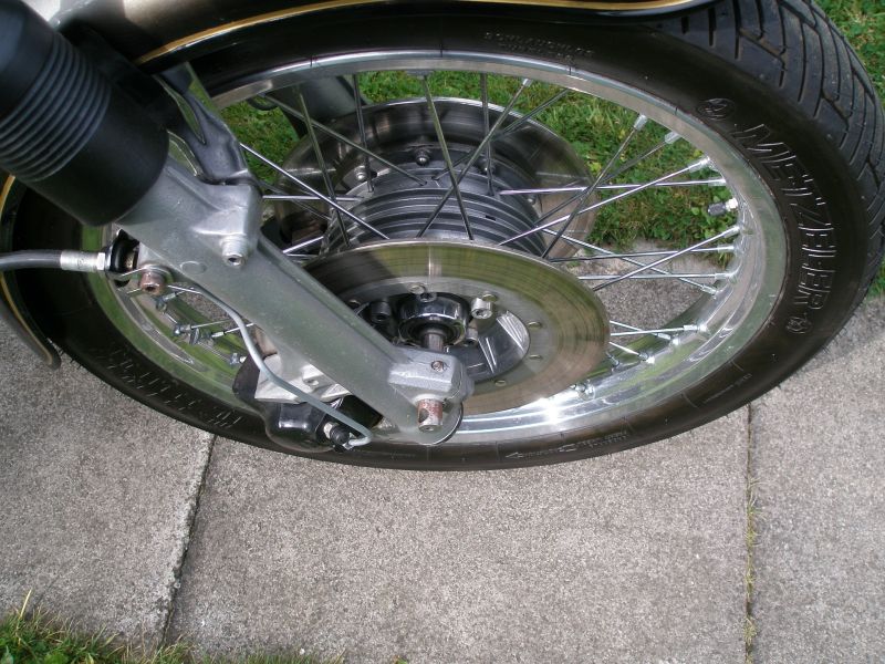

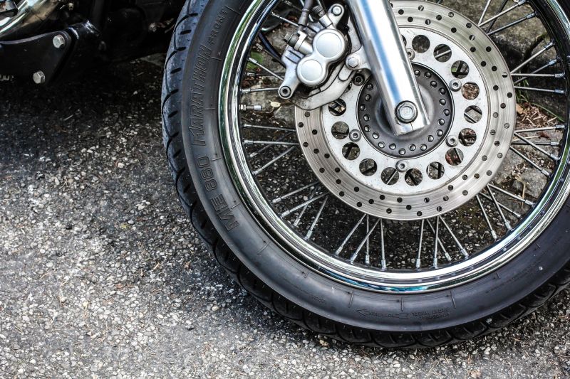

Check your tyre pressure
Motorcycle tyre
If your tyre pressure is too low, the surface area that touches the road will become much greater, increasing friction and causing a much higher level of wear. On the other hand, if your pressure is too high, this will make the side walls of the tyre too hard, which can reduce the performance and traction of the rubber, and cause uneven wear. Always check the manufacturer’s handbook for your motorbike’s recommended pressure.
Opinions vary on how often you should check your tyre pressure, but, depending on how much you ride the bike, you should aim to check at least every few weeks (don’t forget to check them when they’re cold, as hot tyres can affect the reading). You should also always check before you set off, if the bike has been in storage for a while.

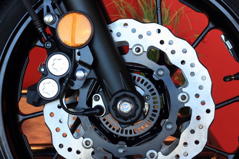

Check the brake pads
Motorcycle brake pads
Keeping your brakes maintained and in good condition is vital for your safety and the safety of others around you. Therefore, you need to make sure that you regularly check for signs indicating the need for replacement. Look for wear on the indicator groove, once the pad is down to approximately 2mm it’s time to replace. Sometimes you can feel or hear the change in your brakes, so look out for that as you ride too.
