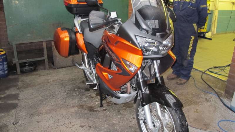

Mine is Orange ! :)
XL 1000 VA '09 In Burnt Orange Honda Panniers Top Box Main stand Scottoiler, grips.
