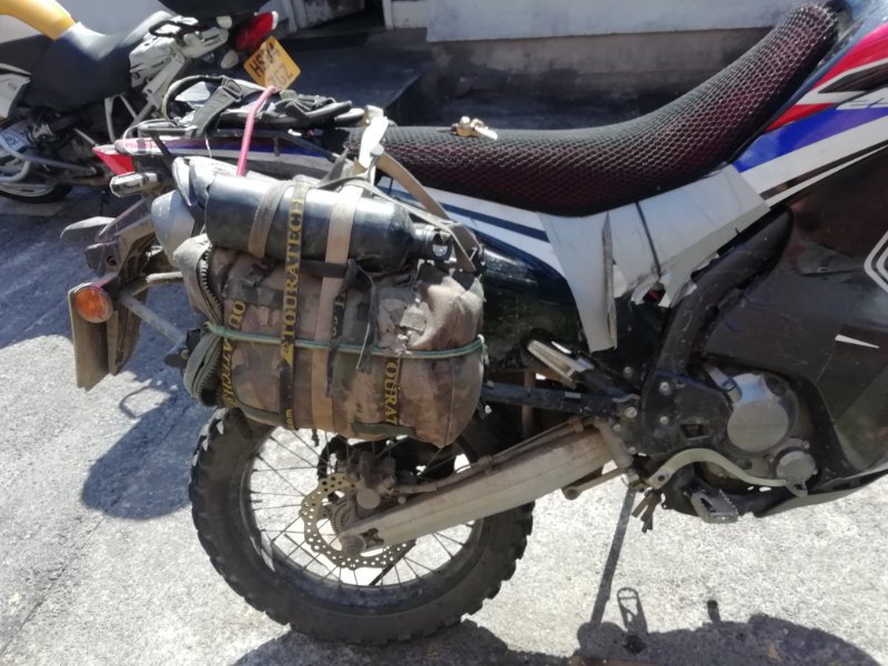

an experimental superlight bivvy only no tent setup, two military pouches, worked OK.

Re: What pannier frames on your Crf 250 rally
my usual bags no more available in the UK so it seems, note I prefer to add a webbing strap around each and another taking the majority of the weight through those two over the seat as conventional throughovers, and extra touratech light straps for final security a bit of a faf to load but completley solid. hope somebody found something usefull.
