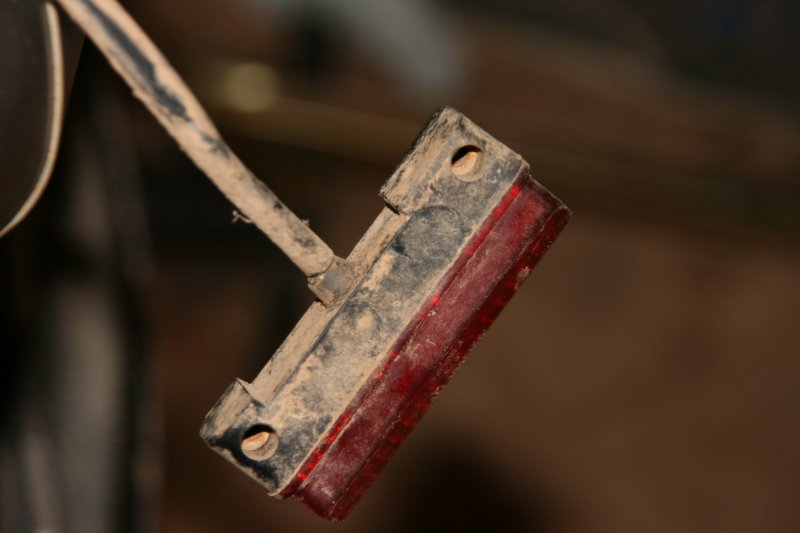

Fitting it is going to entail taking a saw to the stylish fishtail on the back mudguard...sorry, Beta!
First we unbolt the standard lamp...
