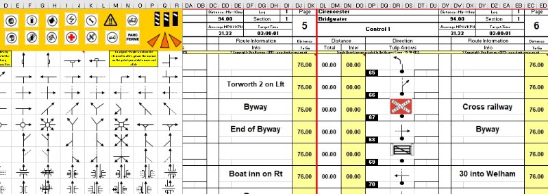

I use the Don barrow Tulip book creator it's basically a spreadsheet with all of the symbols you need, I found Rally Navigator site put too many waypoints in and I never got my head around the printing. I think I paid about £22 for the Don Barrow setup, lifetime usage.
DonBarrow Tulips.jpg (71.19 KiB) Viewed 4681 times

Fair enough - yeah the spreadsheet is only really any use for paper roll production. Maybe with a subscription to the other web site it becomes more clear on doing stuff with the app.
