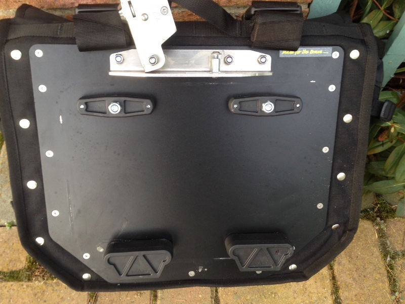

Checking it out it wasn’t a straight fit to the MM frames, but not difficult to make them fit. All it needed was to raise up the bottom puck fittings by 3 to 5mm.
I got Cliff to do a special order for two straight sided bags with matching keys and then set about modifying them to fit. Fitting wasn’t difficult. I removed the bottom puck fittings, locked the pannier to the frame with the top fitting, marked up the new positions and redrilled the holes. I then used a hot glue gun to seal the old holes.

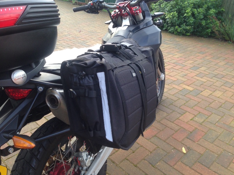

The result is panniers that lock to the bike with no straps across the seats and no straps interfering with the fuel filler.
In use I fit lockable Kriega Steelcore security straps to stop the bags being opened. I know that doesn’t stop a stanley knife but all soft bags have that problem. My prime concern is an opportunist thief when parking at a motorway service station. At other times I will have taken the contents with me.

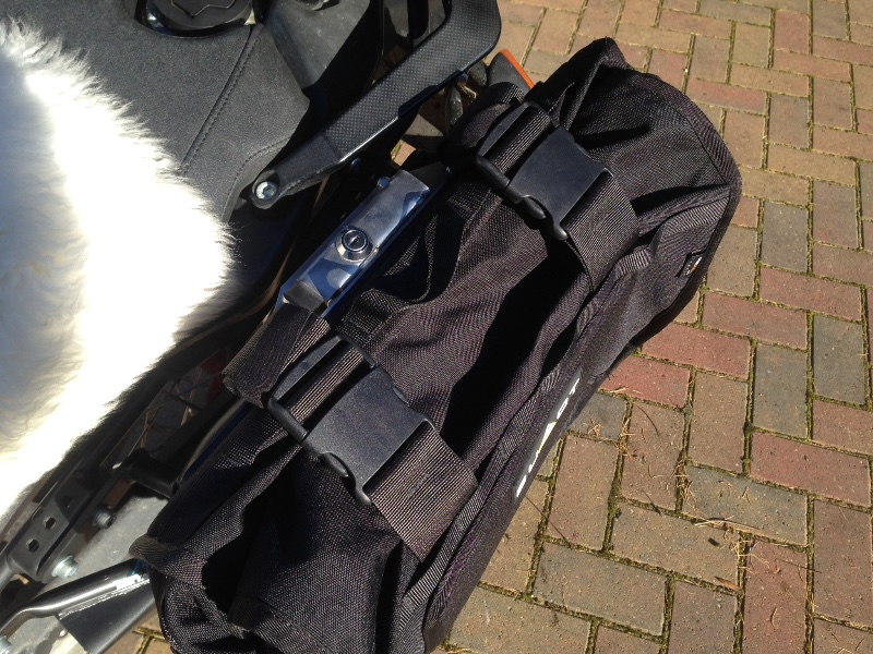

Pannier locked to frame
Backing plate showing locking mechanism at top and fittings that have to be raised up at bottom

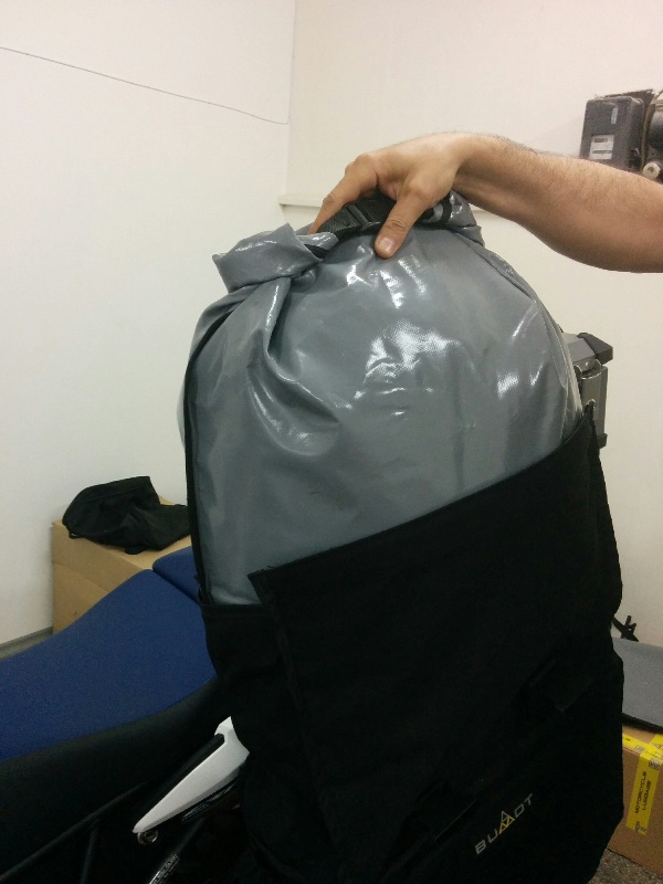

Waterproof inner

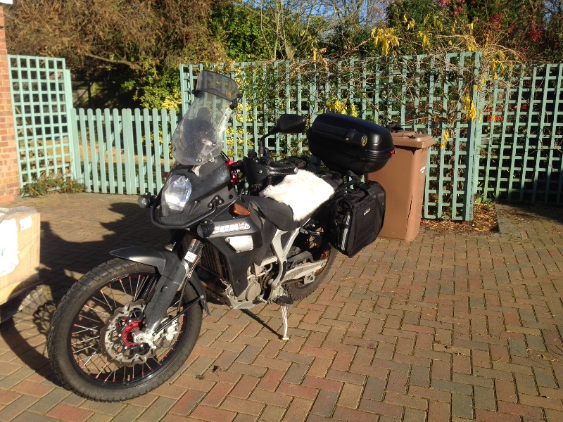

CCM GP450 and Bumot soft bags

Full pannier showing Kriega Steelcore stap through Molle fittings:
Bike view:
