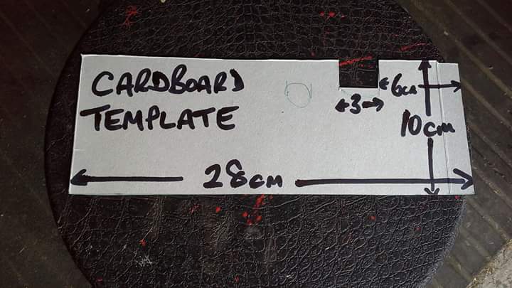

Changed the plugs, just look at the state that they are in after about 11,000 miles, service manual says inspect at 6,000 miles and replace at 12,000 miles, who is going to inspect them at 6,000 miles considering the amount of work to get access.
The coil towers were very tight in the cylinder head, had to use a small pry bar to get them out and we all know how dodgy that is.
Some corrosion on the towers, for some reason Yamaha have a steel section in the towers which is corroding.
The spark plug rubber shrouds must be getting hard with age and are not a perfect seal.
Water must be coming through either side of the front engine mounting bracket where there is a gap.
Looks like we need a small shield on this bracket to defect the water, made up a cardboard template.
This must be a common problem.

I made a guard, piccies attachedDark Knight wrote: ↑Tue Aug 08, 2017 7:21 pm
Attached with strong double sided tape

Changed the plugs and the bike is now running fine on a run out today, poor idling may have been caused by the corrosion on the plugs, as I have four bikes which I share the mileage on, the plugs would have been in the bike a few years.
Another point, as there is corrosion on the plugs, probably sensible to blow out the spark plug recesses before changing the plugs with the compressor to stop any bits falling onto the cylinders.
Must see if I can order up some new coil tower rubber shrouds which would be more flexible.
