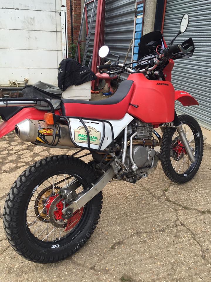

I have plastic side panels on my XR650L. I'd like to give them a refurb.
Anyone know of anywhere it can be done?
Thanks

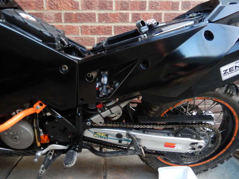

just in process of doing mine, could do with a a machine to buff it a bit more but doing it by hand getting a pretty good result though I probably won't get the depth of shine on mine.
Rub down panel
3 coats plastic primer 600 grit rub down on last coat
4 coats colour 1200 grit rub down after second coat 1500 rub down on last coat wet'n'dry allowed 12-24 hrs between coats nice hot day in sunroom
3 coats petrol resistant lacquer 1500 wet n dry last coat.
Turtle wax colour magic black lost count on how many applications so far. see slight improvement after each.
