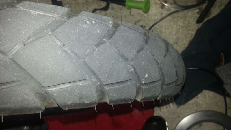

At last i've figured out how to get pics onto here.
So here are two pics of my tyres. They are the OEM Metzler Tourance that bike came with from new.
They have exactly 5k on each.
So is this normal wear. I am not worried as i have a nice new set on the way thanks to ABR.
90% of the riding the bike has done is road.

You could maybe spread the load & wear pattern a bit more across the width of the tyre by lowering the pressure a bit.
If you're light & don't carry a passenger or kit for most of your riding you could easily drop a few pounds below the recomended to compensate.

I have Tourance EXP's fitted on my 2012 F650GS, I have done 7500 miles on them now, the rear only started to square off about 600 miles ago and the tread is now getting low, but I should get another 800 miles or so out of it.
My riding has been varied and I do chuck it into corners, I never ride to conserve tyre wear or fuel B)

I'd be looking to get nearly twice that mileage from Tourance rear on my Vara. Bit more on the front

Mike - there are many forum members that are far better qualified to comment on the tyre wear conundrum then me, but IMHO thats looking pretty sh*gged !
