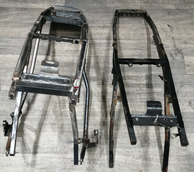

Been real busy so slow progress, subframe is finished. Will get it powder coated this week.
Here it is compared to a old 640 adventure frame

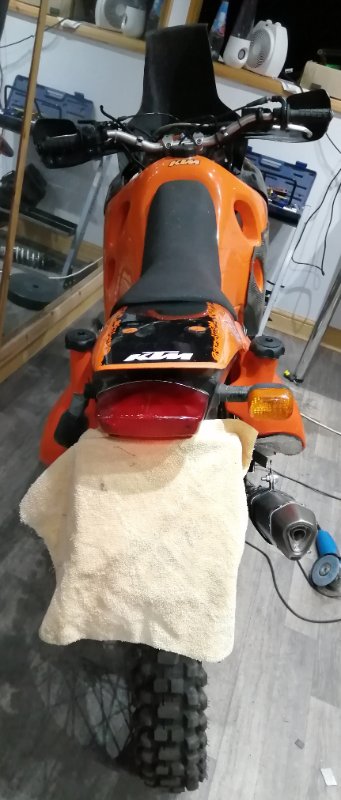

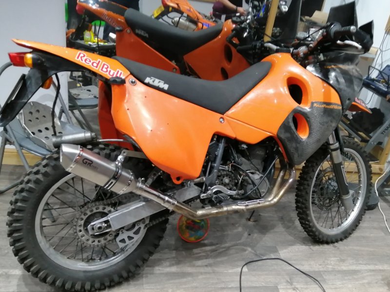

Put it loosely together, never had a stud long enough to hold the left side tank on hence why is laying down.
Well that's its basically done
Ready for spray job on subframe, front fairing and front tank side protectors this Saturday.
I found a site that does decals also so will fit a set
http://www.hyena-mx.com/en/categorie?id=4682
While I'm waiting for the parts to be sprayed will clean it up
Once back will then run wires to the rectifier and solonode, fit new indicators, Handgaurds and grips and fold back levers.
I have a set of mitas e09 I will fit also
