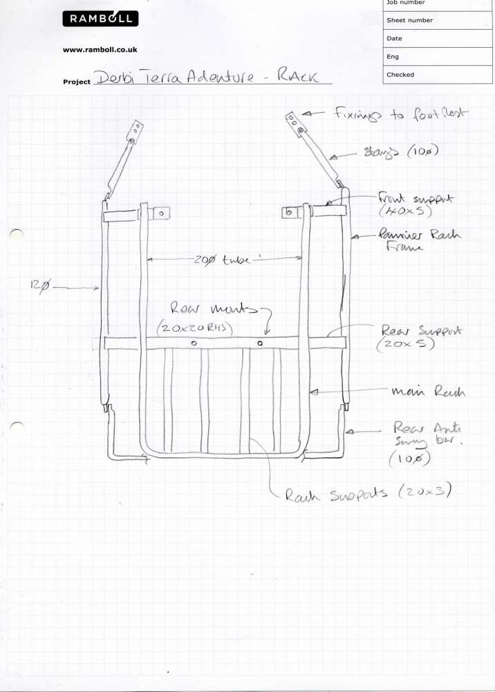

I posted a note a little while ago about making a proper rack and pannier carriers; having now sorteed out all of the fixing issues including the use of the pilion foot rest fixings, I am seeking an idea of how many to get made as this affects the cost.
The design is based on the removal of the existing composite rack and replace this with a tubular one (this can be used on it's own) the panier racks would be supported from the new rack and steadied from the pillion footrest mounts. In addition there will be an anti sway bar at the rear. Suggesting mld steel powdercoated satin black but could get other coulours if there is sufficient demand. I have attached an initial sketch of the proposed rack and you will see that I have not tapered the rear of the rack to give better support/mounting for top case/baggage.

Tim, that looks good, I had to try and visualise it for a while, and can't quite work out what the parts are made of that directly attach to the bike, are they tubes or flat bar? Also are you aiming for symmetrical pannier racks? If so it'd be great to mount a tool tube on the inside of the non-exhaust side so it'd need mounting points.

The rack would have the main frame in 20mm tube so that it can be used as a pillion grab rail. This would be attached at the front usong steel brackets very much like the front fixings of the existing rack. The rear mounting of the rackk would be a 20x20 rectangular hollow section which would be welded to the rack tubes and use the rear monts to fix to. The flat bar would be used for the base of the rack base and the links between the rack and the pannier support hoops. The hoops would be symetrical and it would be possible to add a tool tube on the left hand side.The stays would use the two open ends of the pillion footrst frames and the rear brace would be a simple tube linking eack of the hoops. To keep the cost realistic I have based the design on the use of mild. Steel as this is cheaper easy to weld but heavier.
Hope this helps and hope we can get enough interest to make it worth wile making a few.
