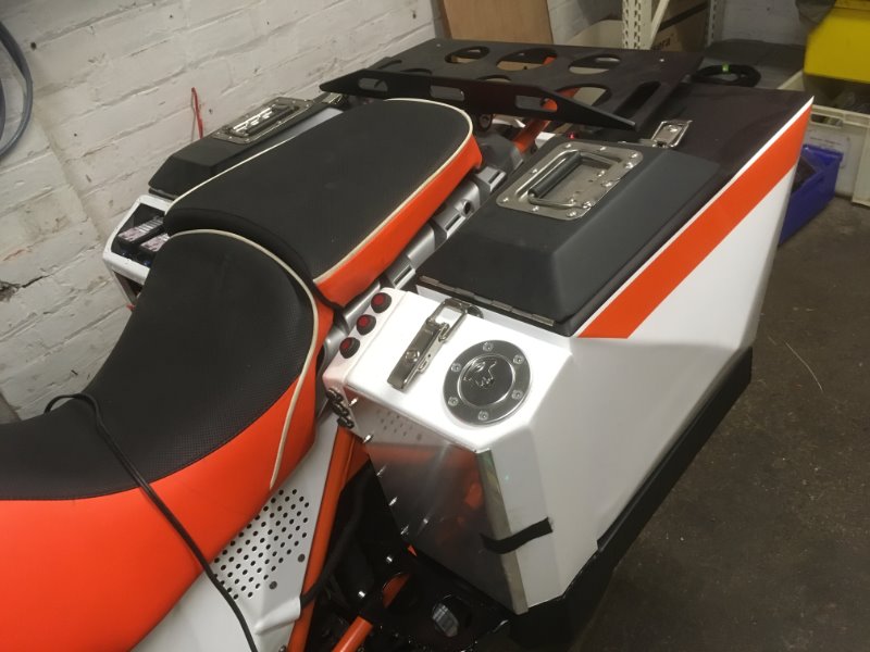

Flintlock wrote:Brilliant - what's going on, on the nearside pannier?
Looks like a filler cap?
There are ‘L’ shaped pods either side that the panniers sit on, one for extra fuel and one holds water, I can clip on my petrol stove underneath and in less that 5 mins have a shower, a feature for the hotter more remote wild camp locations..!!

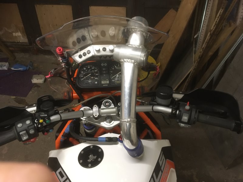

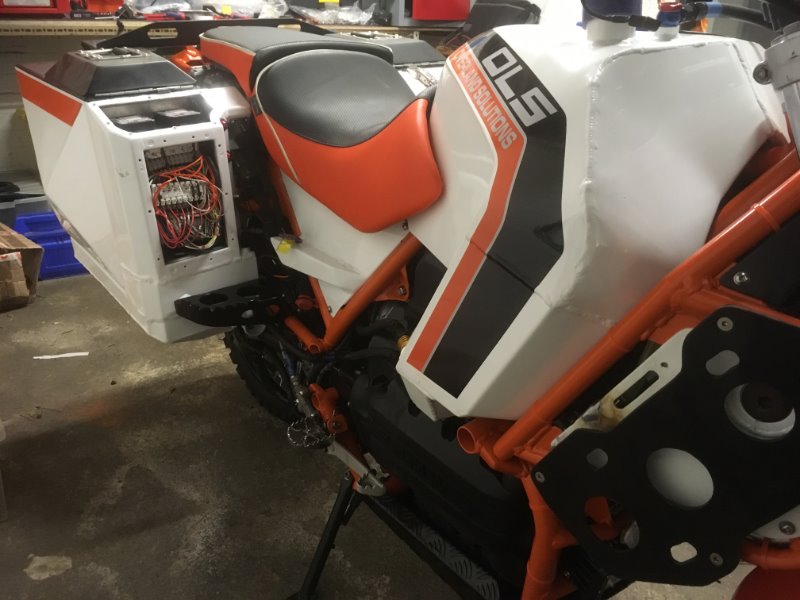

Some random pics
