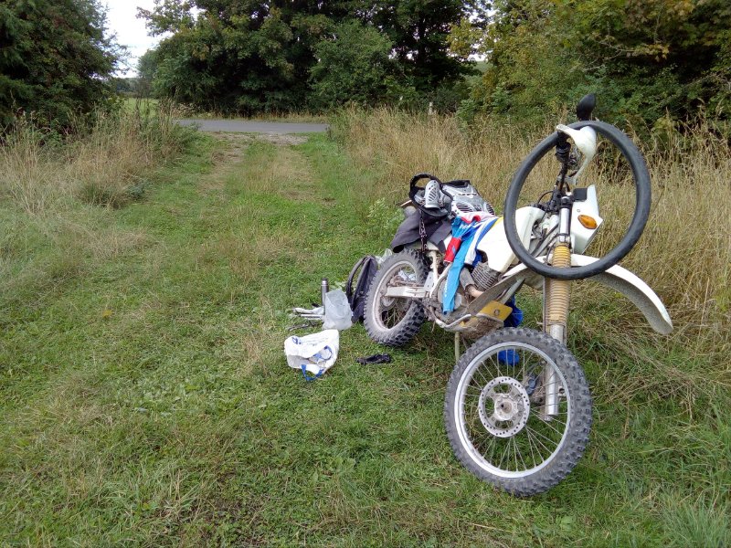

Oct 2022 and a Puncture....
I've mentioned before that I do quite a lot of miles and invariably get a few punctures each year with it. Normally I deal with them without issue, apart from an incident a few years years back when I discovered that the spare tube in my rucksack had a split, and, my patch glue had dried up! :shock: :?
Ooops, lesson learnt and I now check these things regularly.
Except..... my pump, which on the occasion of this picture refused to work until I had spent some time trying to work out which of the little valves in it was not working correctly. And then the spare tube, which I had previously checked, kept going down and I had to repump the tyre several times to get home. :?
Oh well, another adventure, and we made it back to base fortunately and only a little bit late for lunch.

Get you home puncture resolution for a short ride out without spares.
Hugh
Posts: 1346
Has thanked: 945 times
Been thanked: 980 times
Re: My 1993 DR350 Story 2012 - 2025
Post by Hugh »
Greetings,
Thanks be to the Gods for cable ties and gaffer tape :lol:
TTFN
Hugh.

Ah, I have never tried the cable tie trick, I don't recall ever having a puncture near enough to home!

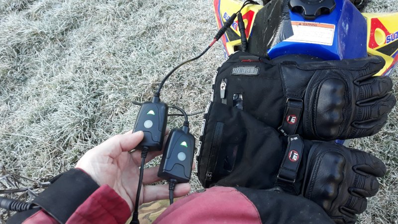

It was November 2023, and it didn't actually breakdown, but when I plugged in my heated jacket the controller flashed red angrily at me and turned off.
Hmmm. A cold ride followed, and once home I found the the bike was only putting out 6V, though strangely the the indicators worked fine and the headlight still shone quite brightly.
A bit more digging and I find the generator is only producing 15V ac on all 3 phases when it should be 50+ VAC.
Swapped out the stator with an untested spare and was very pleased to get the required 50-60 VAC as desired, but.... the output of the rectifier is still only 6V dc. hmm?
136 20231118_115631.jpg (141.98 KiB) Viewed 2395 times
Swapped in another rectifier/regulator, but still just 6V dc .... what???
This was quite puzzling until I had a bit of a brainwave and connected up a 12V battery. Kicked the bike into life and a healthy 14.5v charge appeared - ah, so the rectifier needs a load to work properly and I now know what the problem is. In lieu of a battery the bike has a capacitor fitted which was obviously "kaput".
Fitted a new one, and electrical power has been working fine since! :) 8-)
