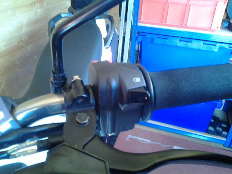

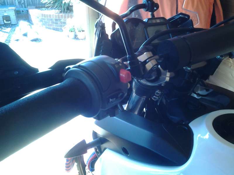

Just thought i would update you all on a part i had on back order from WK since February which just arrived today. I think they sent it by rowing boat via the artic.......anyhow its the left side switch gear which packed up on the high low beam soon after buying the bike and although with some fettling got it working i felt it was a weak point and it would be good to get a spare. So arrived today my initial concern was that its very different to the origonal and thought they had sent the wrong part.....................see pics..............however after a quick plug in and test all was well so installed properly and it feels 100% better quality, especially the high low beam switch, it has no off switch for the dash, this is just on, saves switching on in tunnels i guess, also it now has a pass/flash switch, the indicator switch is much better as is the horn switch, so im acutally rather pleased. Only small issue is the location pin that sets into the bar is on the other end of the new switch so had to drill a 5mm hole so no real issue, the pin is also metal on the new one not plastic as on the old one so all good

Hi netsonic, my switch did the same thing, I've bodged it temporarily so that the main beam is permanently on and I have no high beam. How much was your new switch? I've bought one for a royal Enfield which is much better quality (I've got one fitted to my morini) but I would have to change all the connections to fit it.

Post by netsonic »
It was £28.43, all in delivered, more than they quote on their parts site but considering its an improved version seems reasonable. My guess is Shineray has understood the old switch had a weak point and have improved the design. Interestingly the kill switch has been changed as well but happy with the one i have. If we ever see the new ABS version it should have both switch upgrades, wonder what else is different
