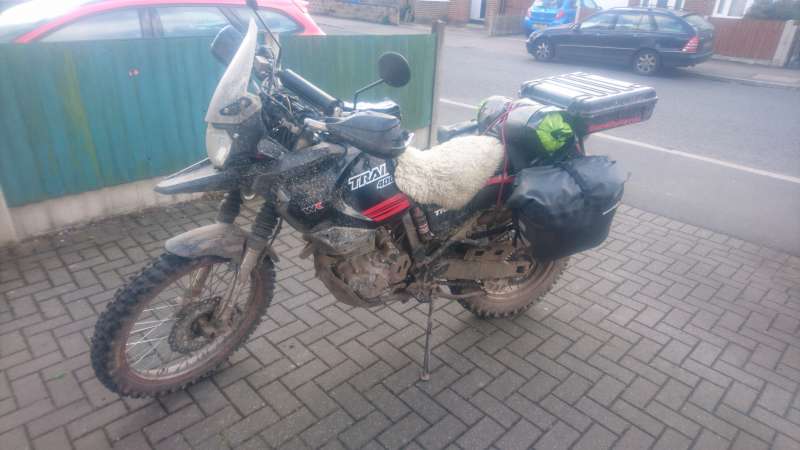

Hi all. Took my bike to the taffy Dakar rally in the brecons this weekend. Did just under 600 miles including the ride there and back, approx 70 miles off road work on the green lanes and a play on a small enduro track. The bike performed faultlessly and was more than capable off road. I have some videos from the lanes and when I get time I'll make a montage. Cheers, Norton

Brilliant weekend if you ever get a chance, most people go trailer/van their bikes but I've rode every time. The wk is alot more comfortable than my ccm 404 was. Good mix of trails, fire roads, slate, mud, grass, big puddles.
I went with the maxxis maxxcross it tyres in the end. They were great offroad, on the road they're OK but a bit sketchy when crossing the white lines, sets the bike wobbling a lot.
