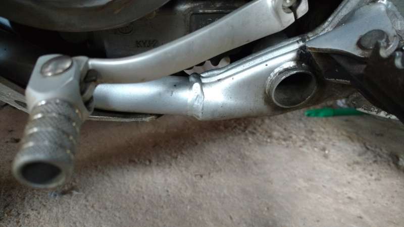

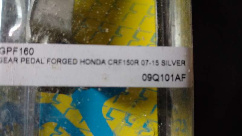

This is a straight swap the tip is folding I'm sure it was the 150 r
apico have a web site 250 l not listed :(
What items from the 250 x fit the l ??
