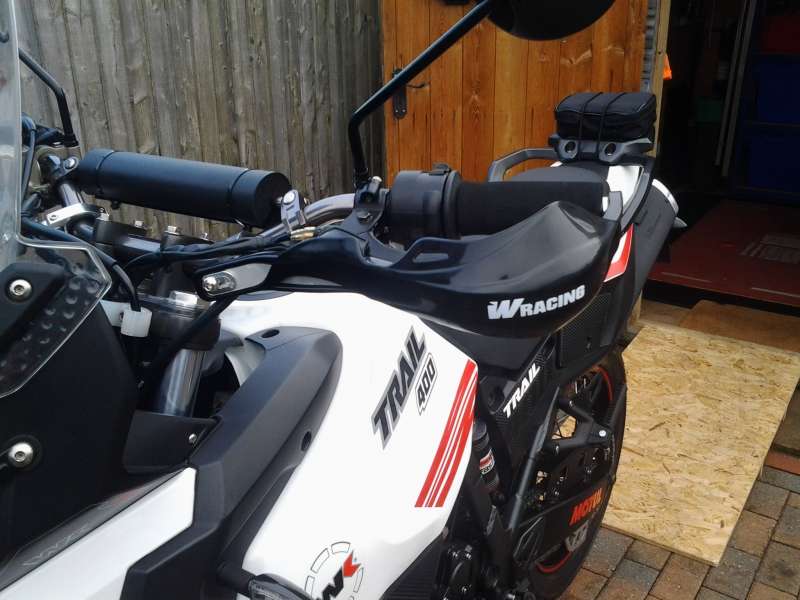

If it's any good these are the hand guards I have fitted and they fitted perfectly (although the clutch side protrudes slightly to allow movement). I also fitted the Barkbuster Led's to these as daytime lights.

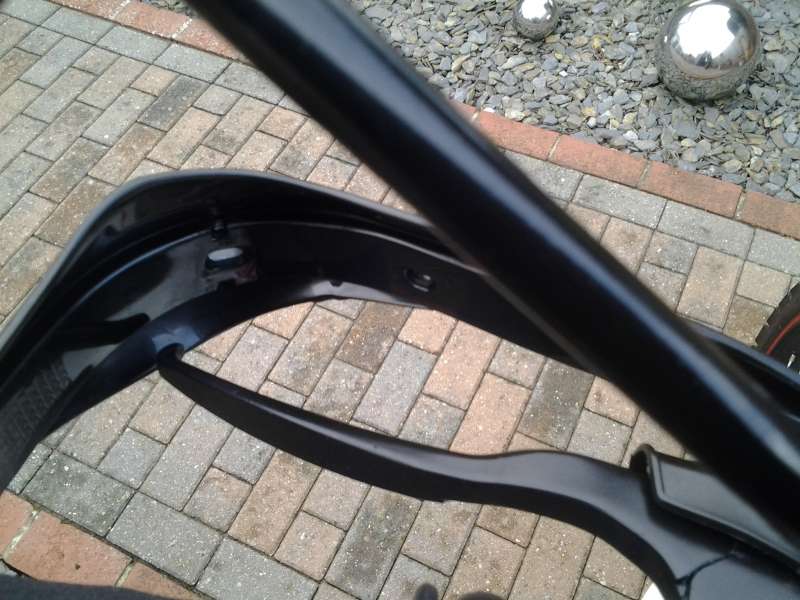

Re: WK400 owners thread.
I think the acerbis look a like i have and yours mac10biker are likely to be the same, mine was from a uk supplier hence the extra cost i guess. For the wk they will fit but needs some fettling to fit right and to feed my ocd......
For the WK, and to get a flush fit at the bar ends the expanding bolts need trimming due to a liner set a little way inside the bar, even with the expanding fixing trimmed you still get a solid fix and flush, however due to the long clutch lever you will need to trim the ball to stop it snagging, i did mine and shaped the end as shown with a little satin black to look factory.....the other point in my view is to get the 28mm clamps as the WK has fat bars which is another great feature of this bike. Now the tricky bit is you will need to trim the threaded block that joins the clamp to the guard by about 6mm so that the guard is pulled in enough to avoid banging the screen, you can adjust the steering stop bolts but not much as it will prevent the steering lock from engaging in its hole
The second picture is before the spoilers were fitted but shows nice fit at the bar ends.....later i also re routed the clutch cable over the guard and outside the brake cable for a smoother run
