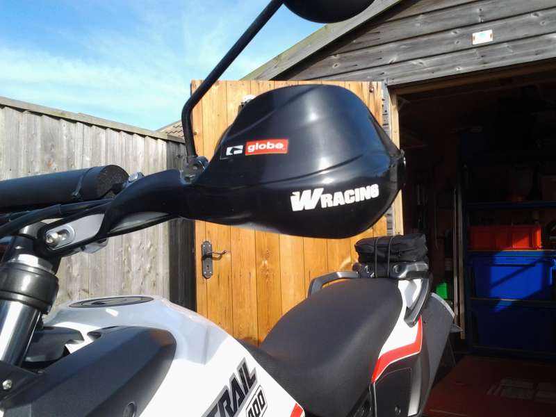

Ive been fettling........added some hand guard spoilers to my acerbis look a likes, keeps a bit of the cold air off as well

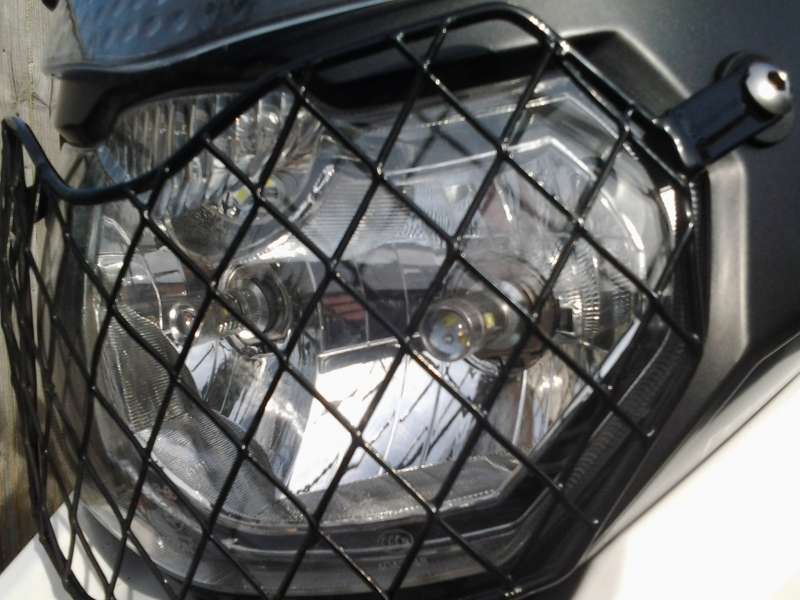

Ive also put some led bulbs in the headlight, i know they dont give the same beam as standard bulbs but dont plan to do any night rides and think they give a good light for daytime drl's, they run a lot cooler as well
I also did the side light with a w5w led .....will try to get a shot with them on later when it gets a bit darker

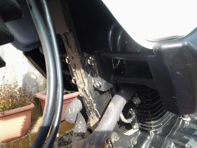

And finally .......changed the slider bar bolts as they are very soft metal and will be removed quiet often to do maintenance. Already looked a bit used having changed the plug and having had the tank off....got some chrome ones same format, 10mm with flange half thread with 13mm ss nut.....

Looking good you might want to change a few of the engine bolts out for stainless steel if they are showing errosion too.Which LEDs did you opt for Bud?
