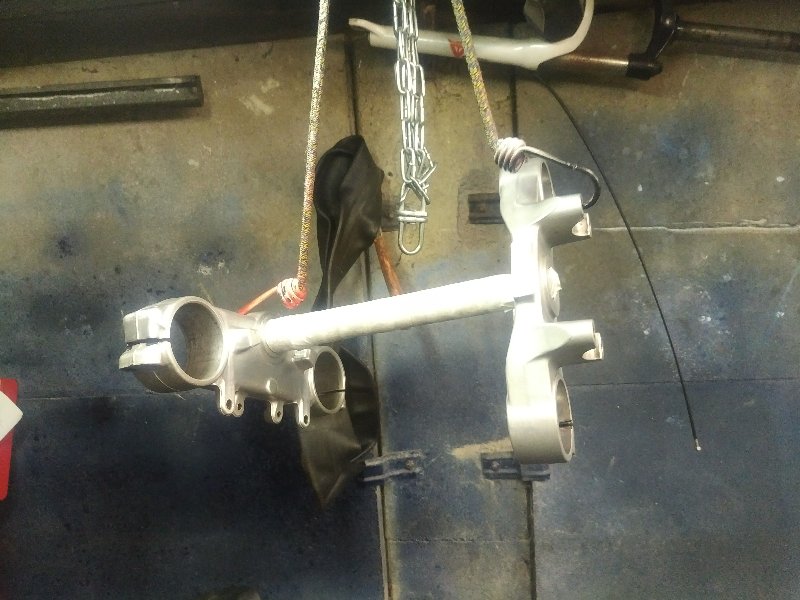

Mikekitts81
Posts: 581
Joined: Sun Oct 16, 2016 10:13 am
Location: North west
Has thanked: 10 times
Been thanked: 57 times
Re: Building a rally bike or trying anyway
Post by Mikekitts81 »
Been doing a bit lately on the bike done my yokes and there all sanded preped and ready for a nice new coat of primer and some colour when I decide what I want to do iam in 2 minds on whether to had risers to the exciting mounts or grind down the exciting mount sand them up then drill 2 holes for a pair of risers the only thing that puts me of leaving them is there won't be rubber bungs in the riser and as it's a 660 thumper I think the vibrations may be a lot worse if I leave them with the exciting set up
All things built not bought . The only way is adventure .
bowber
Posts: 2240
Joined: Tue Oct 29, 2013 9:48 pm
Has thanked: 34 times
Been thanked: 179 times
Post by bowber »
I always change to taper roller headstock bearings, cup n cone balls are crap off road, especially with a heavy bike, taper roller bearing usually last longer too. They do still need to be adjusted correctly though but you can add a tiny bit of preload.
Steve
Dansin
Posts: 138
Joined: Mon Aug 23, 2010 6:56 pm
Has thanked: 6 times
Been thanked: 60 times
Post by Dansin »
I’ve got YZ forks and triples on my Frankenstein Dakar. They were so much better than stock as they were, but were transformed again when I had them revalved and resprung. Work was carried out by Kevin Bancroft of KB Racing in Malvern. He has a wealth of experience of motorbike suspension and the KYB forks in particular.
