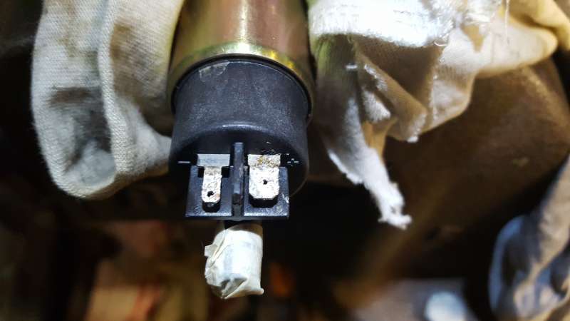

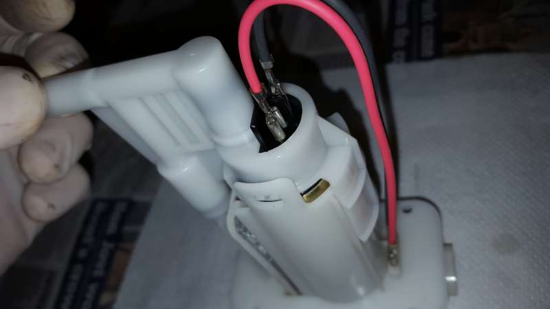

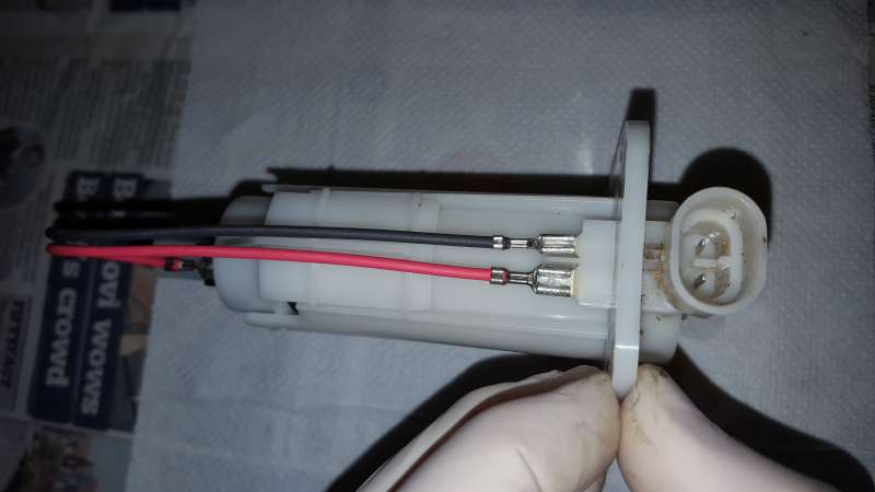

Whilst investigating the wk fuel pump I found the wiring crimp connections are red postive 5mm spade terminal and black negative 3mm spade terminal. Also they are not just push fit on, but soldered as well.
A portable gas soldering iron might be useful for in field repair.
A practise run with my old portable gas soldering iron didn't go too well, so tried my big mains 240vac soldering iron and it was able to heat the solder up enough to remove the crimps the from pump contacts. However getting the terminals back on the pump was not so easy. Juggling the iron heat on the crimp and the spade pump connector at the same time enough to get the solder to flow and push on the crimp was tricky. I managed it on the smaller 3mm but gave up on the larger 5mm.
So I removed most of the solder from the pump contacts
and have pushed the crimps on for now ...
If you ever need to swap a pump out some spare female crimps and lengths of wire for make do repair maybe easier to do out on the trails...

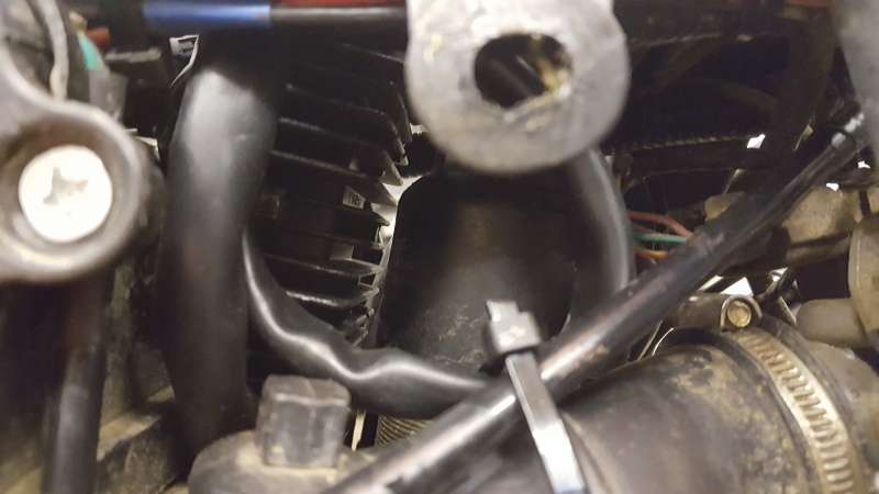

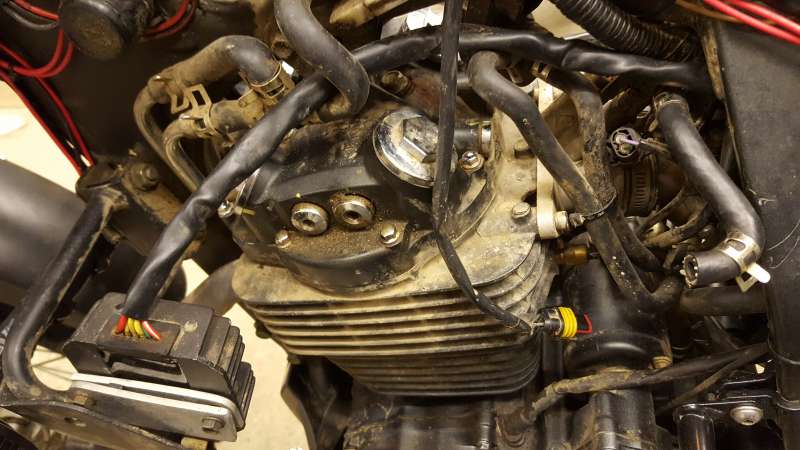

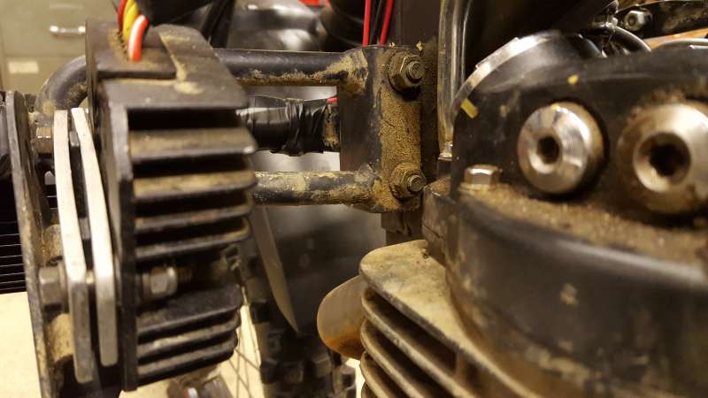

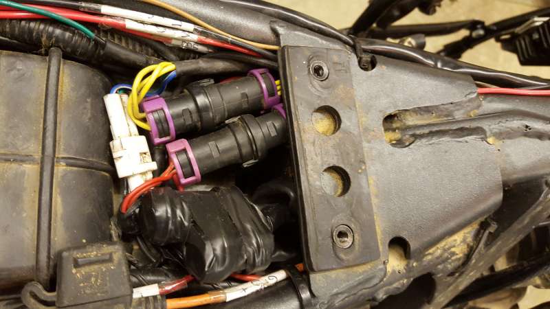

I relocated the regulator/rectifier unit to under the tank in the air breeze on left hand side of the bike.
It is mounted by two aluminium strips gripping some unused framework.
I then added a spare regulator/rectifier unit to the bike and mounted it in the original location between airbox and rear shock
and coiled the wires above the airbox, and covered the connectors up with tape as a precaution.

Nice work and a good standby,are you going to install a spare clutch cable too Glen?
