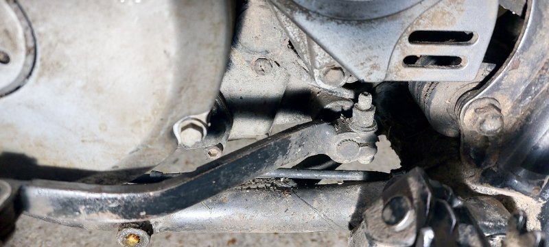

A new bike has to earn some trust with me before being used on longer rides, so I start off with a few trips round the block, then build up the distance while sorting out any snagging issues. Nothing too serious cropped-up on this machine, apart from an annoying problem with the gear lever, which kept coming loose despite being rock-solid at the start. :?
That was a puzzle we will return to later…

Post by Tramp »
If the gear lever/ selector is std bolt through , just use longer bolt from underneath and a nylon nut on top...but file like 4mm off one flat so when it closes around shaft it's tight..and clean the shaft threads up too..
Common problem on xt660z etc...singles love to vibrate..

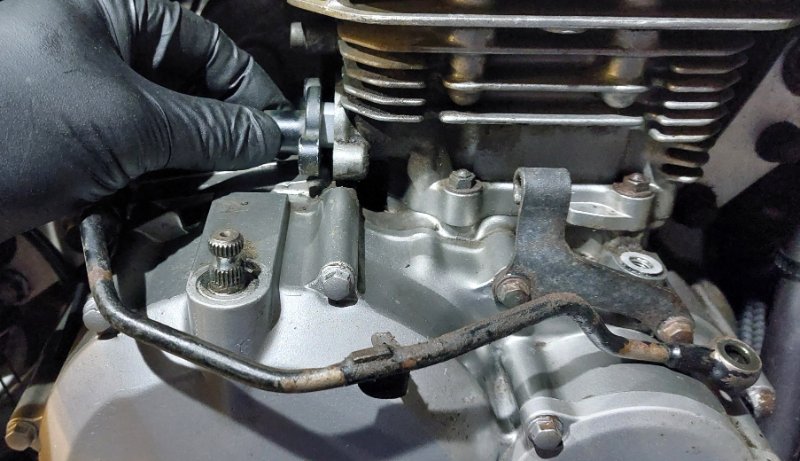

So, yes, this gear lever. It kept coming loose which was a puzzle as I was doing it up as tight as a tight thing each time. I had of course made sure that the split end had a good gap and there was at at least a mm air gap when it was tight. Also, you can see in the pic that I had put in a bigger bolt, with two nuts - it was TIGHT!
Bu eventually I realised what was happening. The spline on the shaft is quite worn where the gear lever had obviously been loose for some time, and had basically created a taper *in* towards the engine. I was tightening the lever with it positioned on the outer end of the shaft, but because of the taper, in use it would work its way inwards to the worn narrower section and become loose.
The answer was to tighten the lever further down the shaft on the worn narrower section. The lever required a small tweak to clear the engine case but can't move now, and stays firm!
