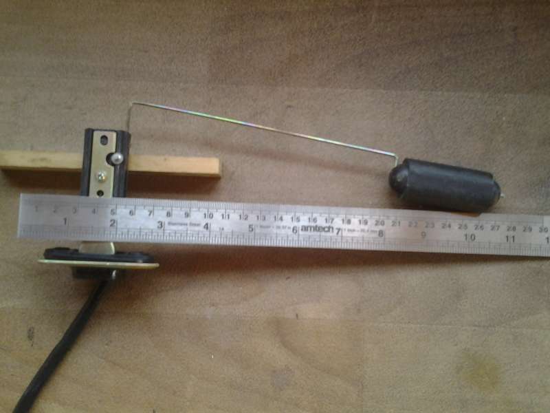

Hi all just a few pics to share some ideas, if you find your fuel gauge is way out on the WK remove the sender and bend the float gently down, ive tried to show roughly
where it can go if you place a steel rule horizontally across to meet the float after bending.........
