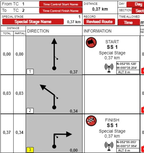

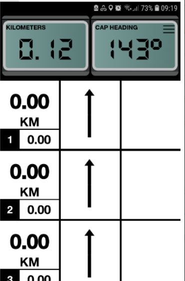

There's a known issue / bug with the free phone app version which I've been told by Mike the guy that runs it should be sorted in a few weeks time
Web site looked like this

phone showed this

Is that what you got? Lets hope it is sorted soon

Exactly that Harv, thanks for taking the trouble, if you become aware that it has been updated stick up an update, I will do like wise, and play a little again. I like the idea of a play with this kinda thing just for the fun of it and to add something new to the riding experience appeals to me. For me as a currently diehard Garmin (montana) user I have no phone hardware on the bike so I would need a second phone, mount, scrolly thingy to make it work. As someone who occasionally helps out with rideouts at events, hypothetically would there be any common interest in something based around this technology at an ABR rally for example. Thoughts anybody?

What I did was to save the route as a .pdf, then open that on your phone with a .pdf reader. It shows everything and scrolls through exactly like a paper roadbook. Works for now until they get the free mobile reader working.
