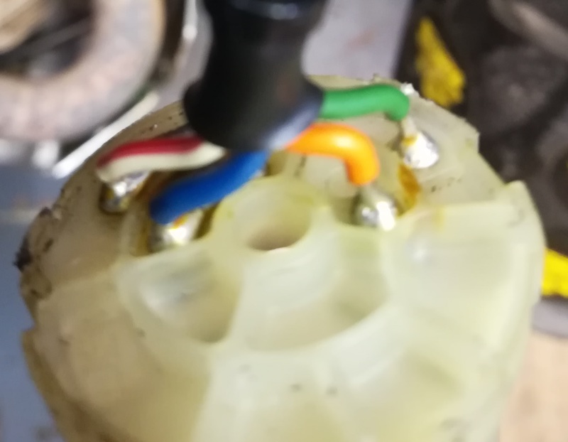

Hello again,
Next door folks have gone away for a few days and taken their retriever dog too so I was totally on my own trying to sort things today
Voltage measured and connectors of the wiring and ignition switch;
I deduce therefore that the principal feed to the switch is the 'Red' wire from the loom which connected to the Orange wire from the switch and that the Green out from the switch feeds all other circuits such as indicators, lights, etc. Searching around I found a single loose White/black trace wire which had no end connector terminal and no voltage but it traces back to the ECU. So I presumed that this might be the ‘trigger’ feed to switch off the ECU and ignition.
I connected the found loose wire to the White/red wire from the ignition switch. With the ignition on and with the engine running I could not measure any voltage at this point but turning the ignition switch to 'off' position the ‘system’ shuts off normally and the engine stops running. I presume therefore that the ‘disconnected’ wire was the problem.
I don’t understand the purpose of the Blue wire from the switch as I cannot trace any voltage from it at all and it only connects to earth.

Does the blue wire earth the ignition via the switch? ie take the current from the black/white wire?
